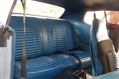

According to the dealer guide, which I realize isn't necessarily gospel, the GTX and SSP had the woodgrain on the upper panels. The GTX I can vouch for. See the attached. The third pic is the back seat of a 71 SSP survivor I almost bought a while back.

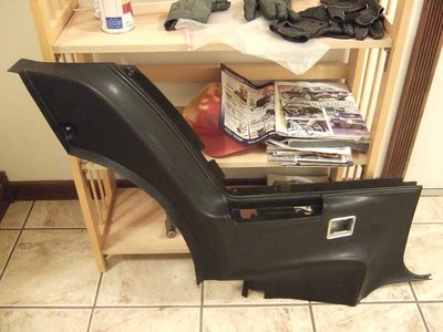

Attaching a pic of a lower panel out of my GTX. Looks about the same as yours.
These plastic panels are made of ABS, which is highly resistant to warping unless exposed to extremely high temps.
The seat bottom you have is too narrow, which is highlighted by the photos. The seat back fits correctly against the trim panels. Maybe the bottom is a poorly done recover, missing some padding on the sides?
