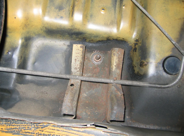

Post by Eric » Sun Feb 17, 2008 2:20 pm
As I'd said in the previous post, there were two hole locations (differing side to side) for bench and bucket cars. The photo shows bench location (taken from under the car)....you can barely see the other hole only in the brace (not through the floor pan) just below. Both front and back align with the welded in bracing shown. Look and measure underneath, your stud to stud (studs on the seat track not bolts) spacing should match the opening spacing in the brackets.

Well, there's no spot welded bracing plate, just a plate that the bottom bolt threads up through (inside holes closer to driveline). They all seem to be in the right place, but I will take pics tomorrow when the carpet is totally out of the car.
Post by Eric » Mon Feb 18, 2008 1:17 pm
The reinforcing plates only came on bucket seat cars, not on bench. Most people don't add them when they convert to buckets
