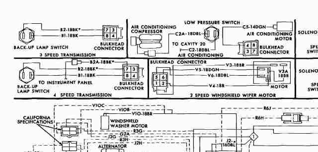

I found these diagrams at mymopar.com
http://www.mymopar.com/downloads/1971/7 ... unnerA.JPG
http://www.mymopar.com/downloads/1971/7 ... unnerB.JPG
I have started rewiring with the harness that has the neutral safety switch, starter relay ground, what looks like the dryer pressure switch wire for the a/c (blue wire).
The diagram A above makes it look like this plug shares wiring with the wiper motor. The way they are grouped implies that anyway. The wiper motor is a different plug.

Post by 72RoadRunnerGTX » Sun Dec 20, 2009 2:27 pm
On the firewall side, the wiper motor connector is separate from the (auto trans) neutral safety/back-up light switch and A/C blower motor connector. They are immediate neighbors at the bulkhead connector however. The dark blue A/C clutch/underpressure switch circuit wire is wrapped with the blower motor wire(green) but connects to cavity #20 in one of the other firewall side connectors.
