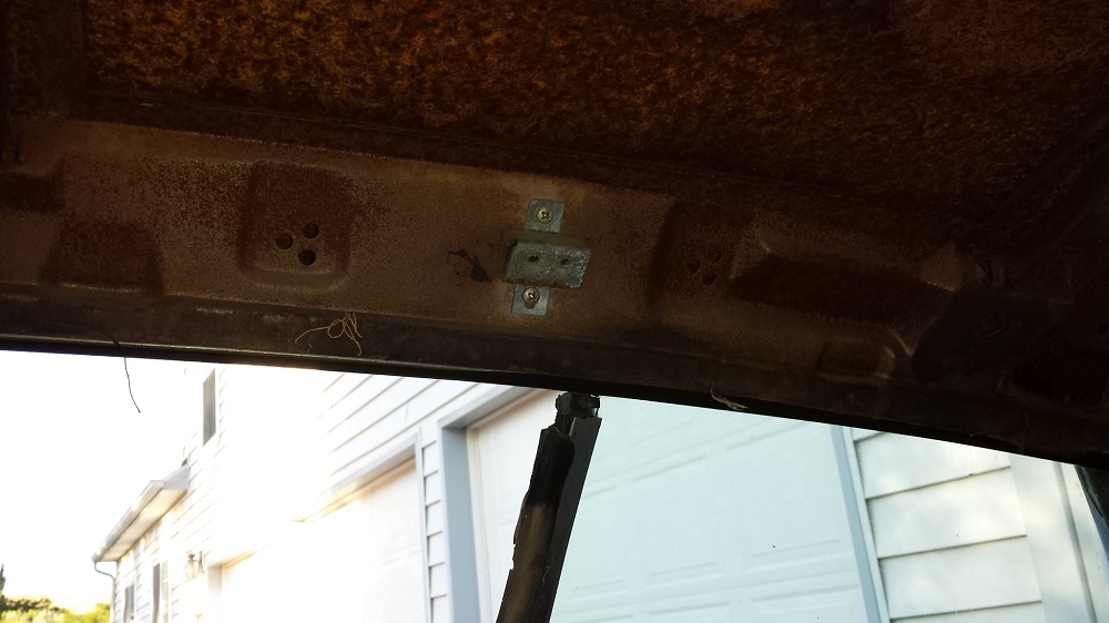

I found my pics!!!
Here we go - the bottom center piece is the clip that goes in BEFORE the headliner. Then the bottom right piece screws through the headliner into the first clip. The top couple of pieces comprise the garment hook that goes on the drivers side.
Here are the shoulder belt clips in their proper place - note the awesome custom headliner that was in my ride.
And here is a couple close up pics of the naked area above the passenger door.
Now you have an idea of what you are looking for - good luck with the search!
moparmarks
Posts: 78
Joined: Fri Mar 25, 2005 3:21 pm
Location: Grand Jct Colorado
Re: CLIPS for shoulder belts
Post by moparmarks » Sat Aug 08, 2015 9:33 am
My 71's have this bracket that goes on before the headliner. Then the bracket shown above that the plastic cover goes on screws to this after the liner.

GTX158
Posts: 79
Joined: Sun Mar 03, 2013 7:24 pm
My Cars: 71 Plymouth GTX (FC7 In-Violet)
Post by GTX158 » Sat Aug 08, 2015 9:49 pm
THANKS MARK!!!There we go that's what I've been talking about. 71 must be different then 72. Notice the difference in the roof/window frame in pictures above.
