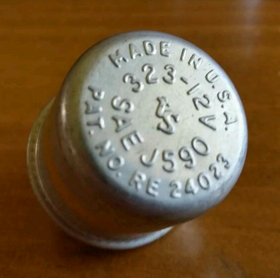

Turn and emergency flashers
71Satellite98661

Re: Turn and emergency flashers
I found the perfect blinker! It's the little things in life
