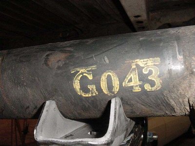

			I'll have to look back through my reference info for axle codes, I assume this is an 8 3/4? For reference, here's one from a 71 car. In this case, the G indicates the year code, G=71 (same as paint codes)....so for your 73 a J would be correct. Just going from memory here....

 ok so on you date code G043 G=71 is the 043 was feb 12 1971 ?

			rav440 wrote:wouldnt " I " be 1973 ? and J be 1974 ?
Nope. "I" gets skipped over in the world of date codes due to being easily mistaken for a "1"

What I meant was that the same way they used the model year as a letter designation in the paint codes (ex. GB5 was first developed for the 71 model year G=71, EB5 before that was developed for the 69 model year E=69) the axle date code year was also designated with the same letter format. This letter=year code was also used on the engine pad.

			I read through this post.  Eric sent me an e-mail to see if I could help.  First off, I am NOT an expert on the 73's--barely know enough on these to try and be helpful.  However, there are similarities between these and the 71's that MAY help.  Eric is correct on the "J" designating the model year 1973.  Just as "G" designates the 1971 model year, and "H" designates the 1972 model year.

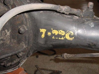

I am going from memory hear as well, but I am fairly certain the "X" or whatever the marking is on the rear of the diff is an indication that the rear is serviced properly (diff lube and the sure grip additive) from the factory on the line.  The "J" plus the next three digits are to indicate the proper 1973 rear axle assembly for the car.  Sorry, don't know the numbers for the 73"s.  My recollections on the last set of numbers:  3-15 plus a letter, are the build date of the rear end with an inspector mark.
I think I am correct on a lot of this.  Of course the best action on your part is to document and research as many 73's you can.  It will help determine some of the numbers, especially the "J and next three digits".
