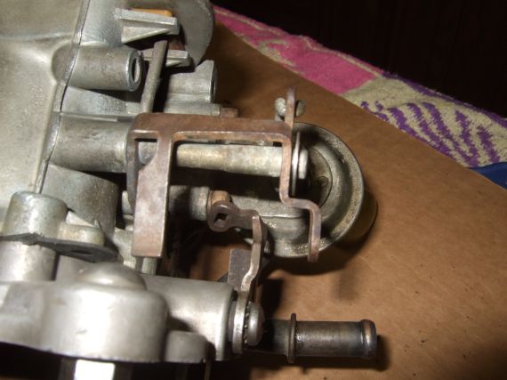

Can someone with a correct, complete + 6 setup snap a few photos of the fast idle cam from as many angles as possible - like above, beside, and maybe behind.
Mine is missing the cam but seems to have the choke operating lever and the fast idle cam lever, although I'm not sure they're correct. My setup is from a 1970, center carb #4376.
Looks like pics below.

Appears you are only missing the cam. Same basic cam was used with all OEM Mopar Holleys, including the 4160 4bbl.

Thanks a bunch. Now if the Pony Express would hurry up...........
