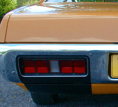

With no tips and the A87 package, you'll have this blackout on your bumper/valance too (tip cars with A87 have the blackout too, but the valance also has half round cutouts for the tips)

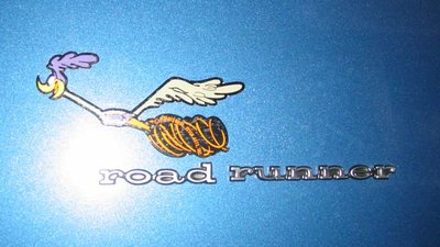

Since your car is not coded for the strobe stripe, this is what you should have on your quarter panels over the wheel (both sides)

Eric wrote:Since your car is not coded for the strobe stripe, this is what you should have on your quarter panels over the wheel (both sides)
Yeah, but the stripe is WAY cooler! :D
