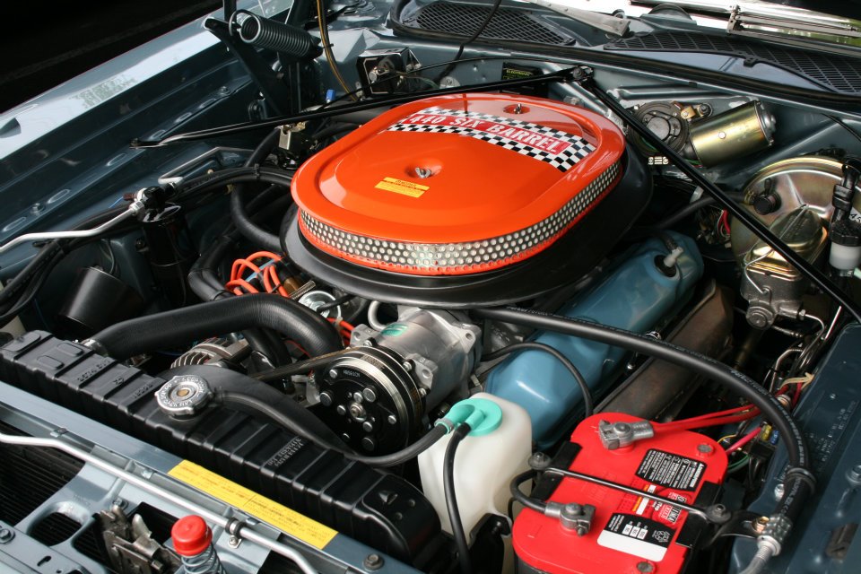

Some changes this off season
As much as I like the fit and finish of the TTI headers and exhaust system, ground clearance at the collectors has been a problem for me from day one. I enjoy driving the car on the street whenever I can but hated always having to watch out for potential contact with normal contours encountered in the road surface. Ordered up the 3” HP manifold head pipes from TTI for their 3” X-pipe system on the car, pulled the later HP manifolds(no heat riser) from the 400 waiting to go into the Sat project (a ways off yet), cleaned up the castings and gasket matched the ports. Considered painting them with a manifold paint but elected to go all natural. I was prepared for a change in the way the exhaust system sounds but still surprised at how much louder the Dynamax Super Turbos are with just the change to manifolds. Now has an intolerable drone at low engine speed/light to mid loads (cruising). I have some 14” Magnaflow SS resonators on order to install in the tail pipes similar to the factory muffler/resonator configuration on these cars. I will have to rework the tips and change the way TTI hangs their tail pipes to accommodate them correctly. I’ll post some shots after completion.
The MP reissue “six-pack” cam seems to like the manifolds much better, I have been able the jet down a bit on the carbs for better all-around drivability. Don’t plan to race the car, so not concerned with a potential loss in top end power as a result of this change.
