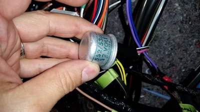

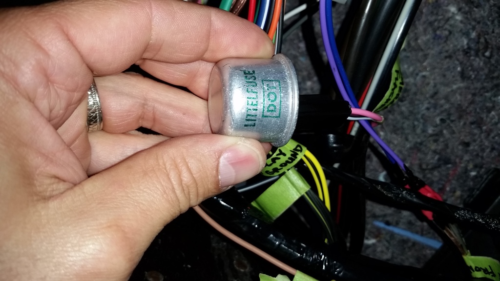

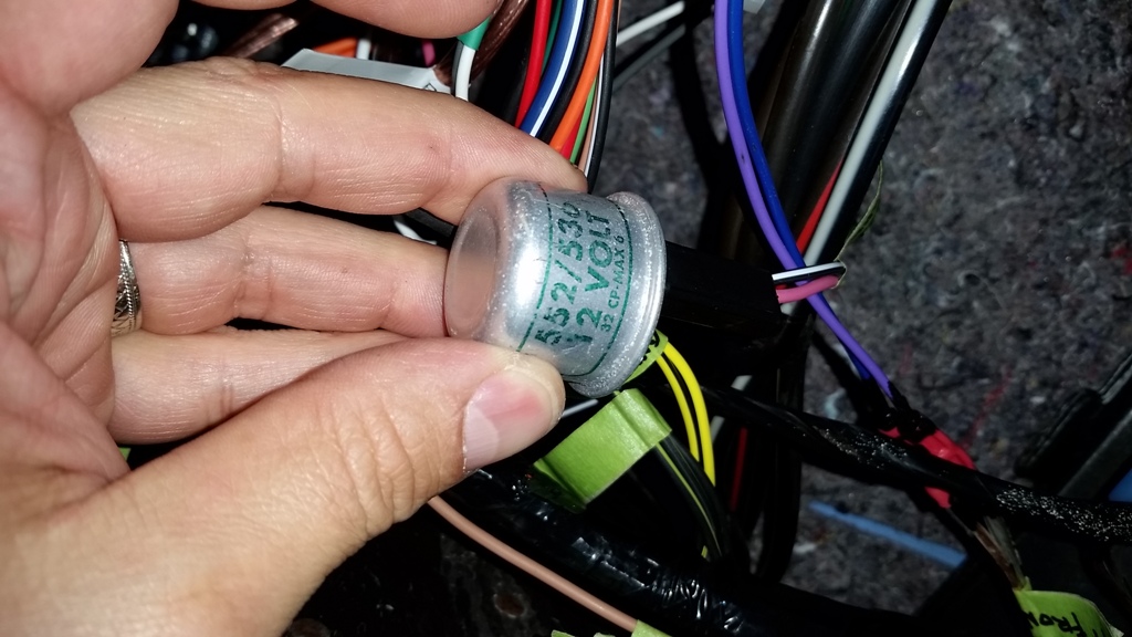

I have an annoying hyper-flashing turn signal and emergency flasher. I have not pulled out the turn signal flasher yet but did see the emergency flashers as a Littlefuse brand 552/536. I cannot find any specification within the FSM or the Operator's Manual. Any thoughts on how I can get theses to flash at a normal rate?

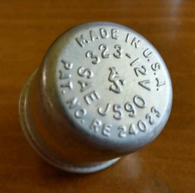

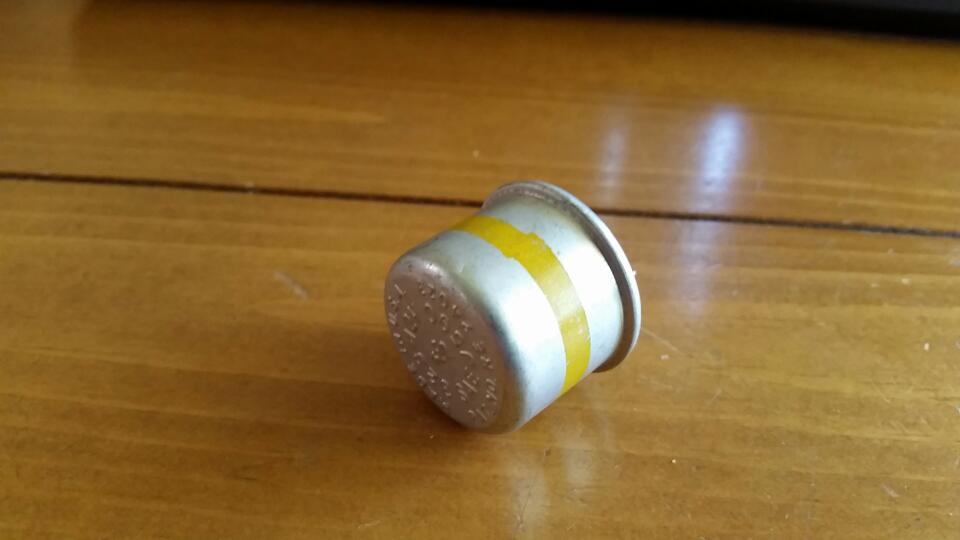

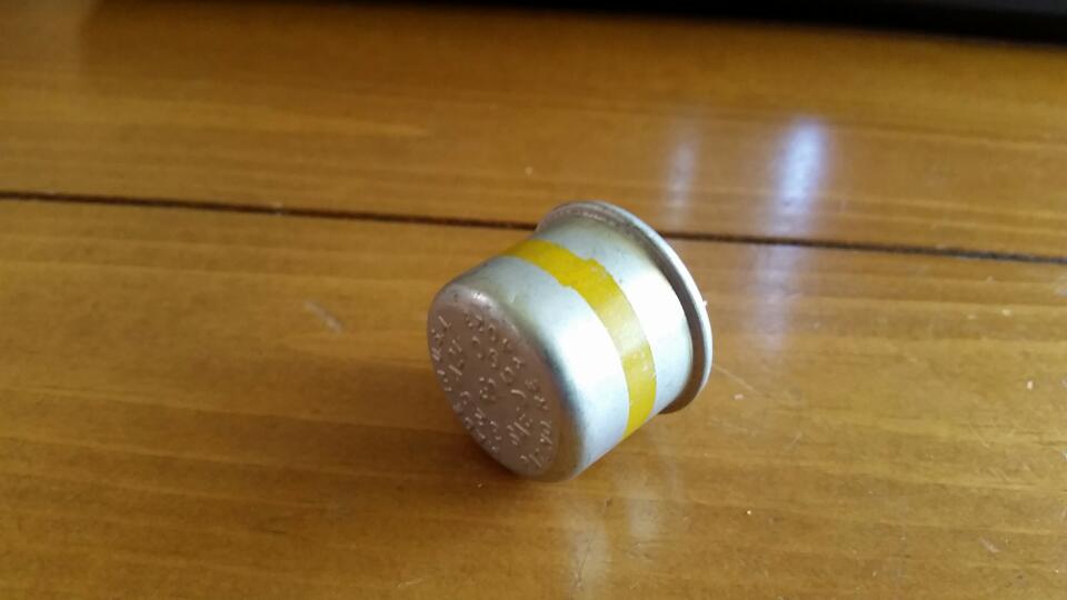

Post by 71Satellite98661 » Tue Jun 16, 2015 1:10 pm
I found the perfect blinker! It's the little things in life
