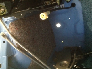

Does anyone have any pictures of how the shoddy pad insulation was installed originally? (1971). I am just about ready to install the heater and A/C box. Would you use something like 3M Super 77?

I sprayed the pad with 3m aerosol adhesive then installed it this is the only pic i have
Image[/quote]
Get your pad out and put it up under dash dry you will figure its position out i did have to trim a section off hope it helps

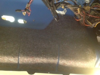

Easier than I thought. I only sprayed the backside of the insulation and not the sheetmetal. The jute is somewhat stretchy and very easy to form around the contours of the firewall.

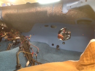

Another shot...

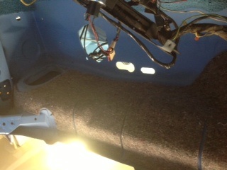

Close up...

Another...
