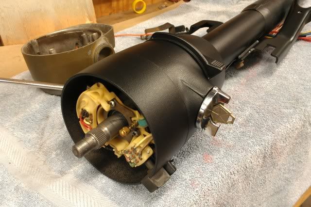

The later column steering shaft should be different as I believe the later cars had a different coupling to the gear box, “rag joint”? That said, all you need from the later floor shift column are the two different cast column head parts, they are interchangeable with the other column shift parts. Just went through another one of these conversions myself.

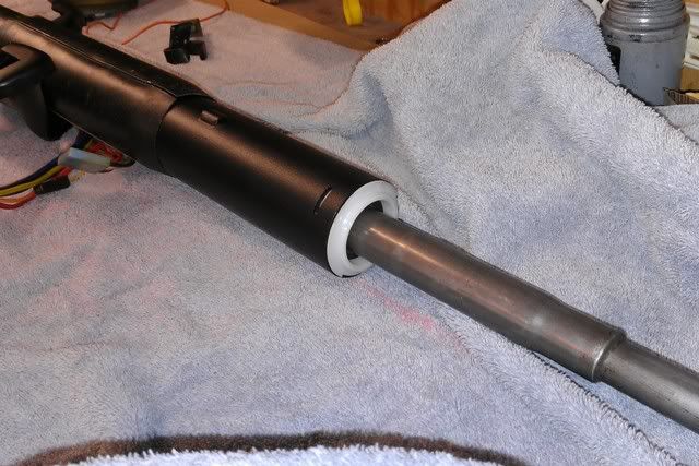

- 72RoadRunnerGTX
- Posts: 594
Re: 1974 Charger Steering Column into a 72 Satellite?
Yes, you should be able to put together the correct combination of parts for the 72’ with what you have. I’ll post a picture later of the column I just converted for my Sat project using a complete floor shift column head that had been torched off a car, picked up on ebay awhile back. Thanks.
Thanks for posting the pics, although I'm miles away from the steering column stage, I got thinking about it, and was worried the one I had may not fit for some reason.
