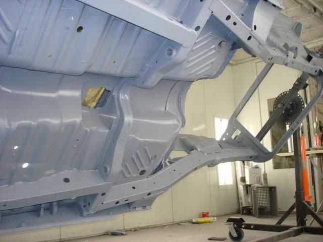

Anybody got any pics of the hole they cut in the floor of their 71-72 RR/Sats for the shifter and linkage to fit through? I bought the tub for the console 4 speed setup. But I don't want to go cutting out this hole in the floor blind . I'd like to have a idea as to the size of it . Any pics (or links to pics) of what you did would be a huge help, Thanks Dave.

Fit your hump to the floor, you should find it locates pretty well in just one location, trace out the perimeter, the cut will be about ¾- 1†inboard of the trace. You can make two holes, leaving the floor pan intact directly above the trans. cross member if you wish.

Sweet , thanks for the advice and pics, it is appreciated. BTW, nice RR/GTX !! I am building this Sat into the 72 RR/GTX I sold many years ago. 440 4 sped Dana car
