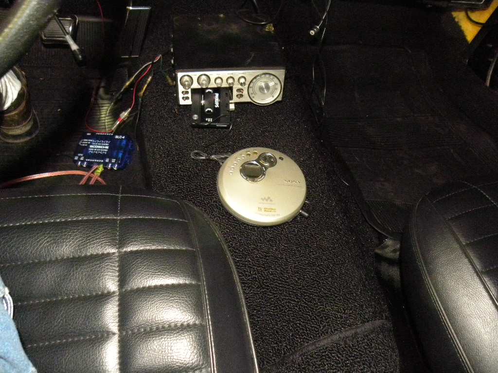

Hi, all. I can take pictures because it's too hard to post on here so i'll just have to describe my deal. I'm all about stock looks with modern results, stealth in other words.A little background just to frame my thinking. I bought my car in 1974 when I was 19, so I kinda am trying to relive my youth, that is until reality sets in. 71 RR with AM radio. I had the original fixed, and the original speaker reckoned. AM so I can listen to Rush. While I was over seas I bought a Pioneer KP-500 Supertuner FM cassette deck, and listened to that.So here we are today. I'm going to use that pioneer feeding going through a speaker level converter to take the ampiflied signal down to a level for an amp. Then I have a 100 watt amp under the package tray going to two 6x9 Infinity reference speakers.I tried an iPod ,but you can't bypass the built in amp on those, and unless you know what you're doing the files are compress and sampled so much that the sound quality is not up to CD standards.So, I had an ole portable CD player ( walkman type ) with a line out jack that goes into a cassette adapter, and I get Hi Fi sound that is loud enough to give you sound fatuge.But what I gain is a complete period look.I am going to mount the Pioneer on the console where a factory cassette would have been.Wish I could do pictures.

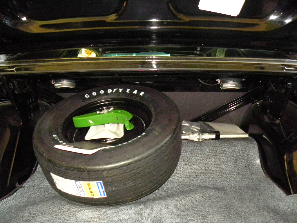

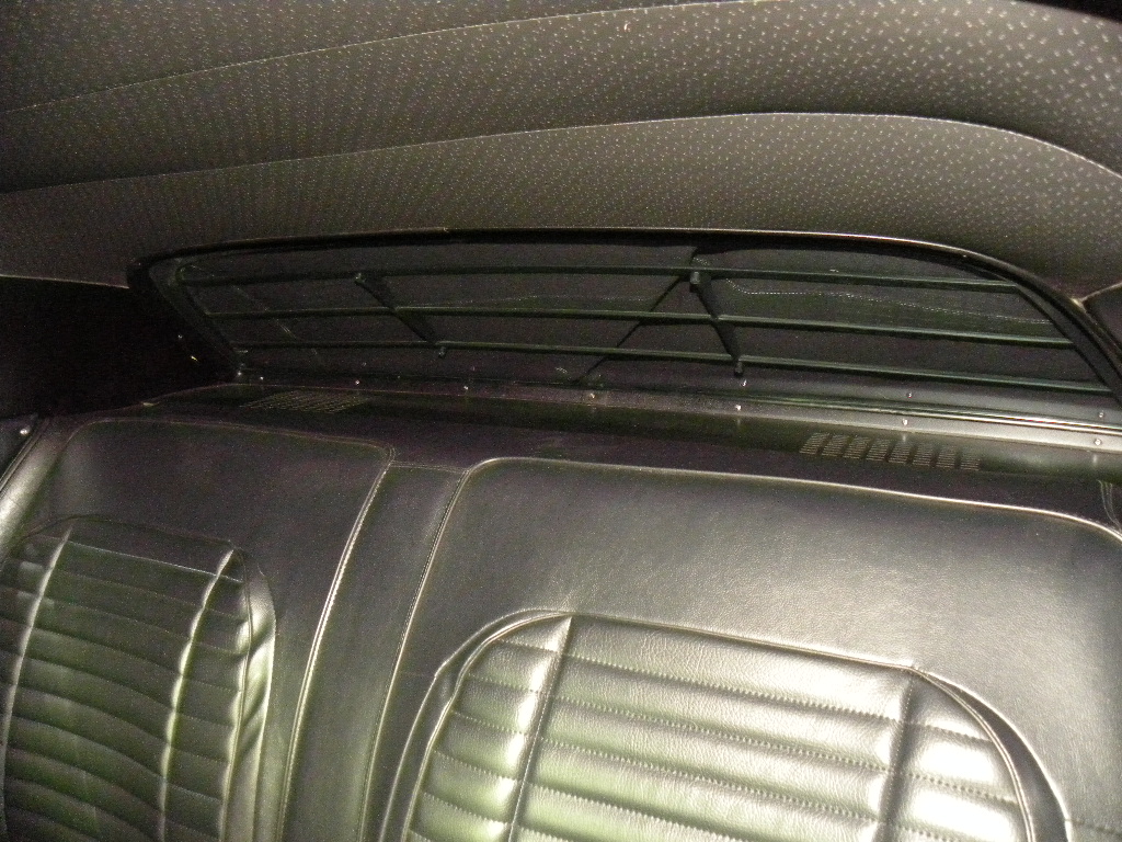

Here's my version of restrosound.I want the old school look with modern a result.I bought this Pioneer KP-500 FM cassette deck in 1976 and used in this very car so I want to keep using it. I reconed the factory dash speaker for listing to Rush Limbaugh on the original AM radio.I tried an iPod but found that a Sony walkman cd player with a line out jack sounds better, CD quality sound.I use the line out to bypass the headphone amp in the walkman,its like having pre outs. Then I use the cassette adaptor to go in the cassette. After that the signal goes into the little blue box which takes the amplified signal down to a lower level for the main amp.In the trunk I have a 100 watt per channel Orion amp with Infinity Reference three way 6x9s.The reason I chose Infinity is that they have the highest sensitivity rating I have looked at.That means they are louder with the same amount of power than other speakers, and at 2 ohms the amp then puts out 155 watts per channel.I ran as many wires as I could inside of the cars structure and the amps power wire through a unused hole in the firewall, and will hook it to the starter so most people will not see it.The tape deck will be mounted where the factory cassette deck was on top of the console,and every thing will be hidden.After hooking everything up just to see how it works,and with just two 6x9s you couldn't stand more than one song with it turned up very high.Anyway thats how I'm doing it.

Heres the rest of my pictures.
Can't hardly tell anything is there
wites were run inside the structure
