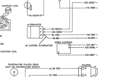

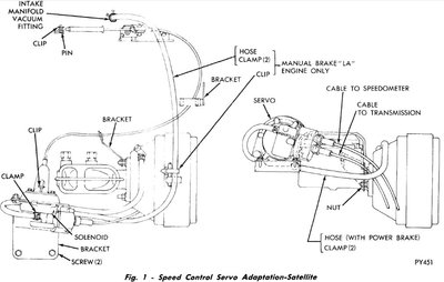

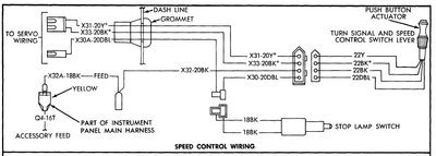

I've attached a screen print of the FSM diagram of the speed control. Also, the engine side and dash side wiring diagrams.
If you want, send me a PM, and I'll send the whole electrical chapter PDF to you. It has operation and troubleshooting descriptions.
