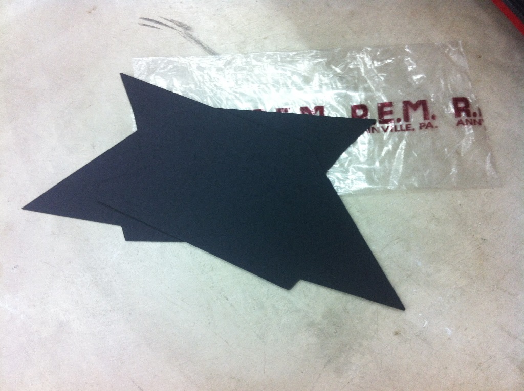

Post by Eric » Sat Jul 20, 2013 7:51 pm
I purchased these sail panels from Dante several years ago....no fabric covering, no texture either. Not sure if they're still available. Lousy cell phone pic is the best I can do right now....
Posts: 526
Re: Headliner bow attachment
Post by 71bird » Sat Jul 20, 2013 8:32 pm
Eric wrote:I purchased these sail panels from Dante several years ago....no fabric covering, no texture either. Not sure if they're still available. Lousy cell phone pic is the best I can do right now....
Yes those are the REM ones, they are bare cause they think they are supposed to be covered. I've been over this a hundred times over on Moparts.They should have had a couple of glue on things for the snaps also.I talked to REM about it, and they aren't concerned about them not being correct or even close.I had them make me some out of the material as the package tray, its not right, but a lot closer.I saw some not long that had a little texture, but not sure where, maybe Legendary. The originals were a multi layer pressed cardboard with texture similar to the package tray.But never covered with anything.What can I say, except as long as peole keep buying this junk and saying, oh, well, its good enough, they won't make the correct stuff.
