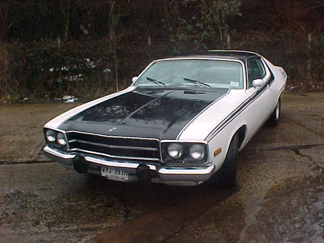

Here's my '74 Satellite bake by the American sun for twenty years then drenched in English rain for ten
Satellite owner from over the pond

Post by Eric » Sun May 07, 2006 8:48 am
welcome to the 'nest moonman....nice looking ride
