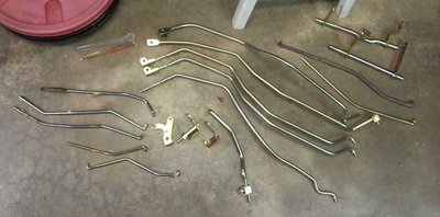

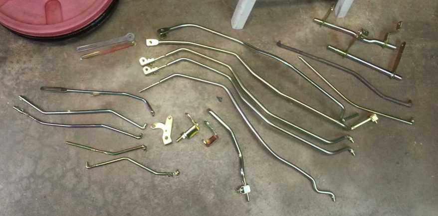

In a quest to find out why this 440 was low on power at full throttle I found that the fast idle choke adjustment on my Holley 3310 was hitting the passenger side of the intake juts below the carburetor mating surface. This is an Edelbrock RPM with no carb spacer. I removed that piece from the throttle shaft as a temporary fix for the sake of moving forward. Now I have an issue with the one piece throttle rod reaching the end of the stroke before the carb is at wide open throttle. If I adjust the throttle rod to achieve WOT, the throttle rod is then "too short" and will no doubt shorten the life of the 727. Because this is an aftermarket Holley with the mandatory throttle lever adaptor is that my issue or do I possible have a throttle rod for a 2-bbl engine? It seems a three piece setup would allow for the adjustment I need but locating that setup may be expensive. I am not considering a Lokar cable at this time but may have to. I've attached a photo of miscellaneous parts of throttle rods and shift linkage thay may help get me there but don't think I have a complete 3-piece set up. Any thoughts?

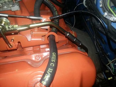

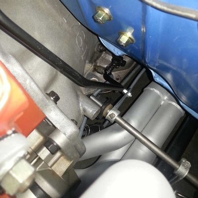

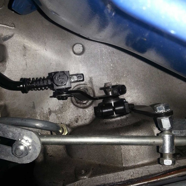

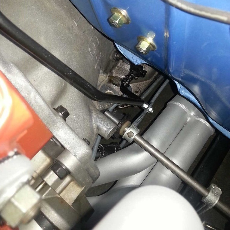

Thank you for the reply. Now that you mention it, I think this trans is out of a 66-67 Imperial. Not sure where the throttle rod came from though. You might be right with the lever at the transmissino being too short. Today I noticed that the throttle rod at the carb end is actually "bottoming out" on the bracket itself (attaching to the intake manifold). I am realizing what a hodge-podge this set up is of mine :lol:
Here are some photos. The geometry at the carb looks pretty wonky now that I see it in photos...

1. That is a Performer RPM manifold .. correct? It appears to be because of the runner and the height of the carb, resulting in the steep angle down to the linkage. The "adjustment" to the throttle cable clamp is close to what I had to do as well .
2. Look at your set up vs. the factory picture of the single rod. Look at the pivot link in each picture, ( where the front of the rod attaches to the manifold bracket). The factory has the link forward at rest ( idle position), yours is angled back at rest. For some reason, your rod is positioned back further at the idle position. That is where you're losing the travel.
3. Now look at the single rod in the factory picture. It has the adjustment on the top, by the engine, and yours is down by the transmission. I think this is where the problem is. You need to change to that style rod and adjuster shown in the factory picture. That should give you the play and full range you're going to need to get the full travel and make the proper adjustment- even with the sharp angle with the high-rise manifold.
4. Out of the linkage parts you have pictured, looking at the one piece rods from left to right, I would think the 1st rod maybe, 2nd possibly and 3rd more than likely( and the one I would start with), would be the proper part. 4 and 5- I seriously doubt it.
That's where I would start. Use the factory print as a guide as to what parts to use and how they should be aligned. The wonky ( I love that word :bump: ) angle may not be much of a factor if there is enough adjustment. I will post the procedure for making the proper adjustment of the linkage tomorrow. It's 1:30 AM and I need to get to bed. This getting old crap isn't working. I was supposed to die young and handsome :D

Now if you get this done and the carb still will not reach wide open, then we'll need to look at the lever on the transmission. Or if the lever doesn't move the full swing- or 80-90% of it. I have to check, or someone could chime in that knows for sure, how far the lever is supposed to move in its arc of travel. I do not know that information absolutely positively for sure.

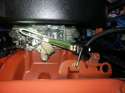

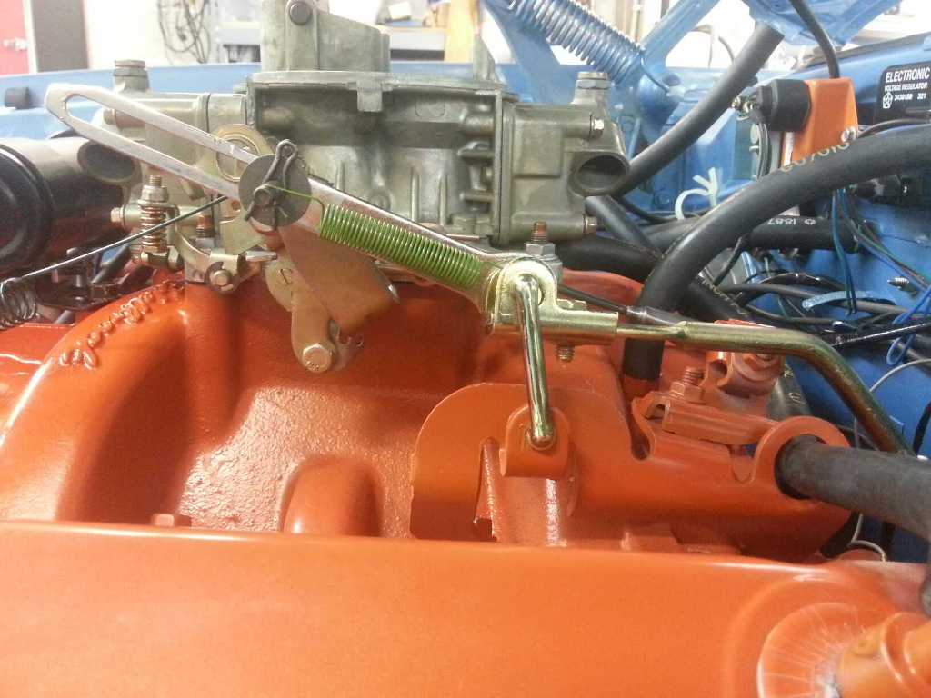

We might be in business now. I took one of the spare throttle rods, bisected a straight section, threaded both cut ends with 3/8-16 tap, added coupling and jam nuts then elongated the slot at the upper end of the throttle rod by about 3/4". I now have full stroke of both the throttle rod and carburetor throttle. Adjustments per FSM now leaves the adjustment slot right in the middle for fine tuning and I think I'm ready for a test run. Thanks for the help, I've added a couple of photos of the modification...

71Satellite98661 wrote:We might be in business now. I took one of the spare throttle rods, bisected a straight section, threaded both cut ends with 3/8-16 tap, added coupling and jam nuts then elongated the slot at the upper end of the throttle rod by about 3/4". I now have full stroke of both the throttle rod and carburetor throttle. Adjustments per FSM now leaves the adjustment slot right in the middle for fine tuning and I think I'm ready for a test run. Thanks for the help, I've added a couple of photos of the modification...
Thats what you have to do to make the 383 rod work on a 440 to make up for the extra height difference. Good luck.
