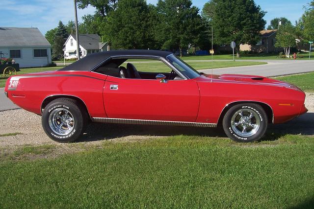

We still jackup all our cars and put larger tires out back.Some people don`t like them,but I think most do.Our Cuda is the most extreme and it does very well where the public votes. It got best of show last year at a show of 63 cars and a top 10 at a show of over 300 cars so quite a few people still like them like the old days.It never did well when we would show in stock trim.

First, great Cuda!
I remember a black,340,72, with L50x15 tires, on slot mags.
They only stuck out to the edge of the rear fender, so wasn't raised much, looked tough!
