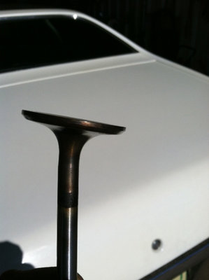

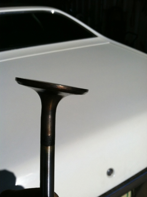

This isn't supposed to look like this, right?
Re: This isn't supposed to look like this, right?
That's not good.
How does the piston look? Everything else stay together? Did the push rod and lifter stay in place?
Surprisingly the piston looks pretty good--a couple light marks and a ding... the cam and lifters amazingly still look like brand new. I may have lucked out about as well as I could have. Only about 2,000 miles on this engine.
So what triggered it? Over revved, part failure or questionable guide clearance?
471Magnum wrote:So what triggered it? Over revved, part failure or questionable guide clearance?
At the risk of sounding like a smart ass, my right foot.
bruce wrote:Damn heavy right foot...
Not cool
2000 miles on a rebuild? I would be talking to my engine builder
Don't care how bad your foot was in it that's a dropped valve. NOW IF ALL 16 floated and kissed the pistons Then I would say Ya your fault as you floated them, But They are all bad not just one or two!!!
All will have kissed the pistons not just one or two if you floated the valves, some lighter than others some harder than others due to spring set up.
I have been guilty of this myself once or twice
That said I would be inspecting Keepers retainers springs. Personally I would throw all away buy all new.
I always use New hi quality springs retainers and valves in any engine I build. these parts while reusable in many cases do have a cycle life.
Also if you suspect you did indeed floated the valves and you used Cheap Cast pistons during your build I would inspect ALL of them VERY carefully for cracks. I personally would discard any Cast OR Hyperconetict Piston that kissed a Valve.
