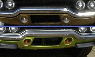

Post by billzilla » Mon Mar 03, 2008 2:58 pm
Why are some Satellites orange and some clear? My 71's are clear and I think original, delorean's '72 has orange.

Thanks for asking this!! Also the shots of our cars looks cool! :D I like both the clear and the orange, but on my car I like the contrast of the orange on the green.
