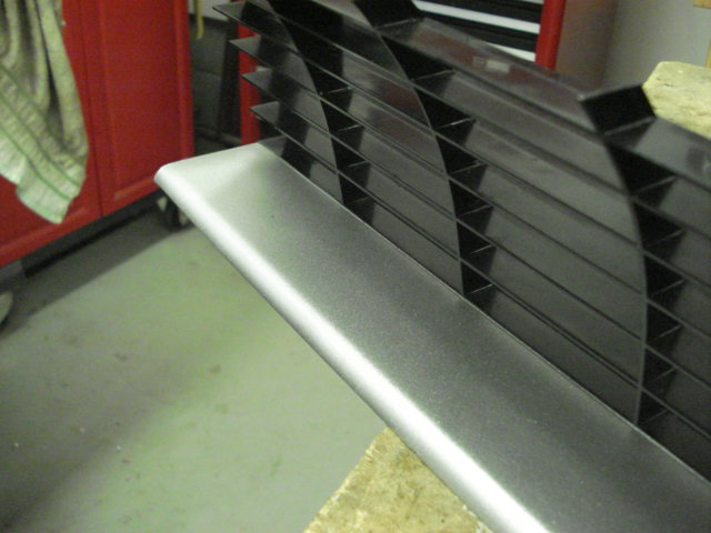

Post by general » Mon Nov 19, 2007 6:14 pm
Here's how mine turned out

Post by rr6pak » Tue Nov 20, 2007 5:21 am
Hey General, your grill looks gooood from what I see. What kind of paint did you use? My grill is mostly there but the right headlight I will have to paint. If your lucky enough to find a real NOS cool, but for those who cant, then I guess painting them (from a Sat, or GTX) is the only other alternative.

Post by general » Tue Nov 20, 2007 9:25 am
The black is not painted, I just cleaned andcleaned and polished and polished and then polished again the grille with Mequiars plastic polish. It probably took me 20 hours to do including the light bezels. There was many years of accumulated grime on the surface. The Mequiars polish is not very aggressive. Then I wet sanded the part that was to be painted. I didn't totally remove the old finish because I figured it would be a good base since its been there 37 yrs. Then I used non-textured light argent paint from Totally Auto.
Post by Eric » Tue Nov 20, 2007 7:30 pm
Rod
I agree with General, the non-textured grill silver from Totally Auto is a very close match for the original.
Post by mopar71 » Wed Nov 21, 2007 2:26 pm
Beautiful job there General! 8)
