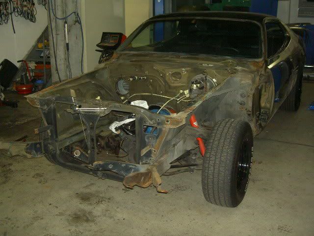

this was the car before the works...

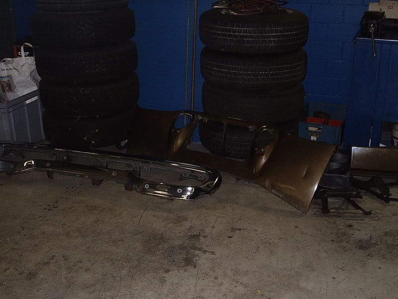

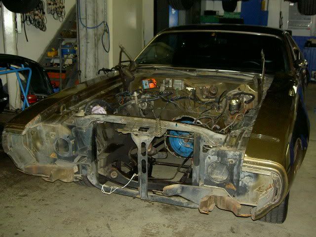

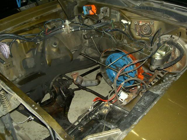

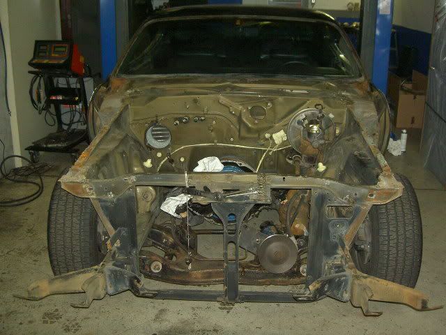

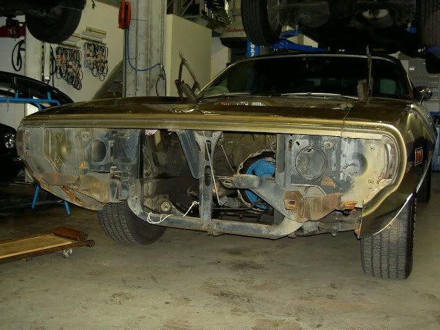

first the engine and front...

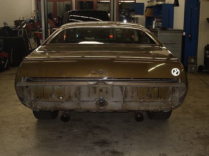

then all other parts...

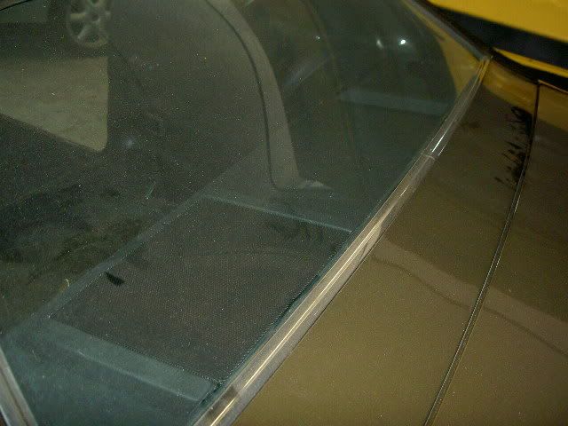

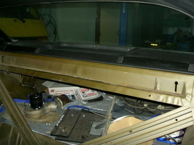

...these were the only rust-holes... (under the windshield)
before:
after:
before:
after:

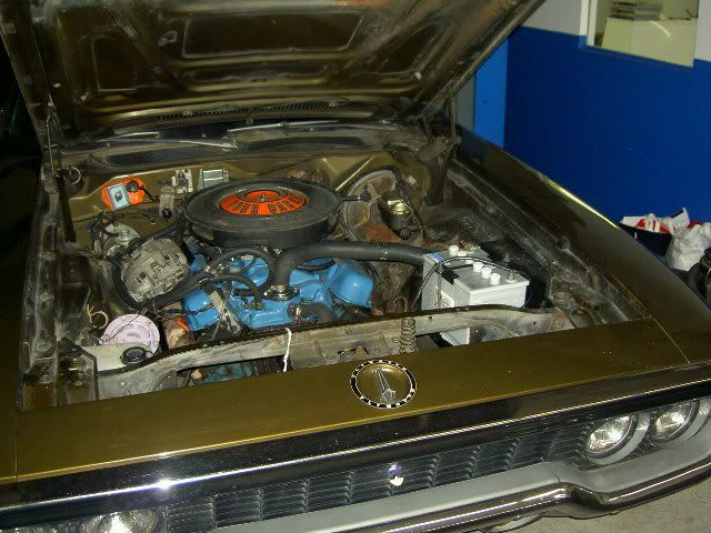

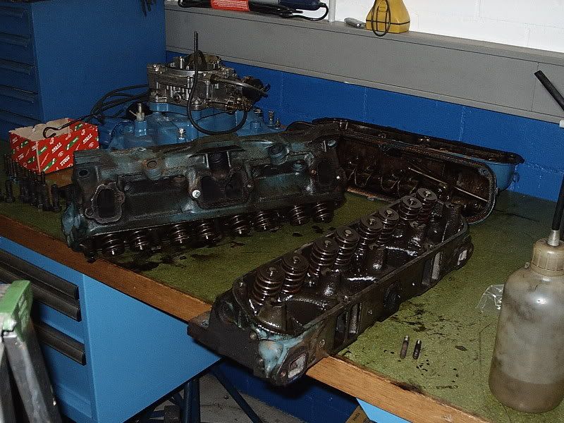

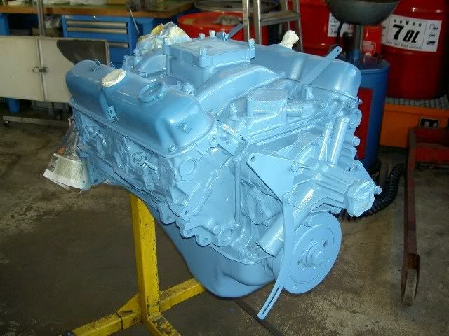

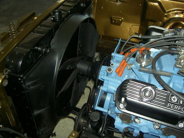

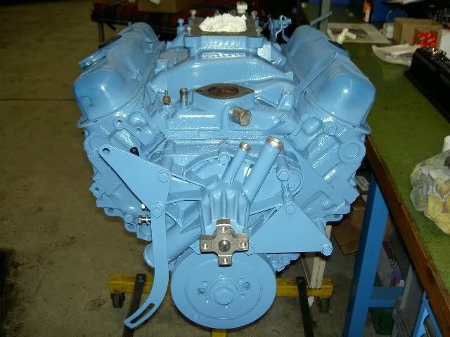

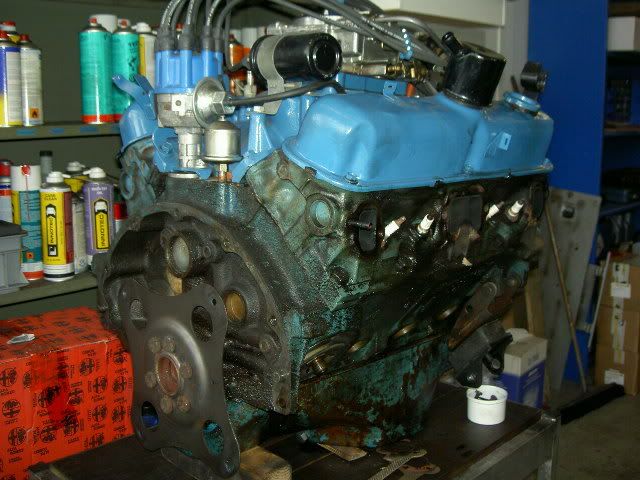

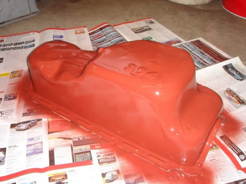

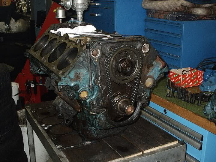

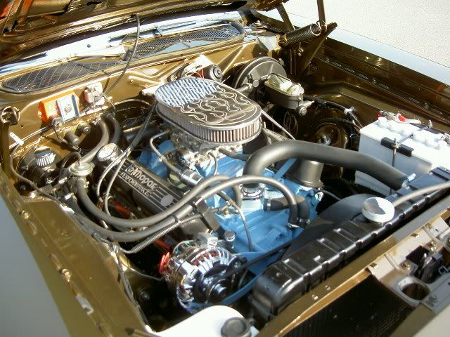

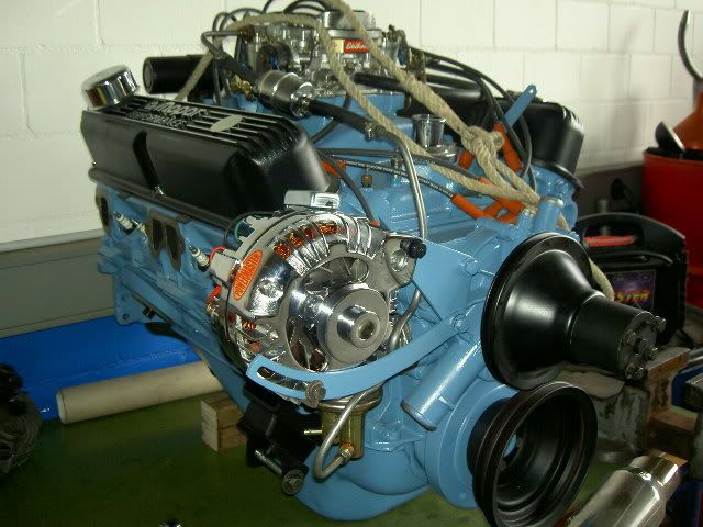

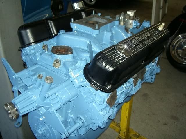

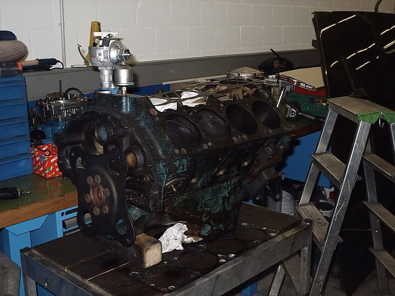

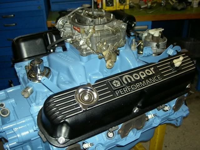

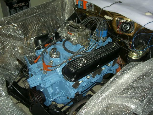

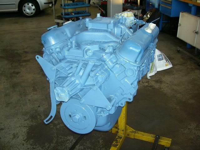

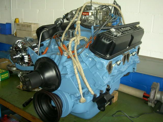

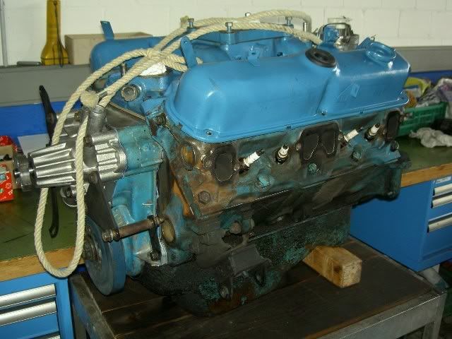

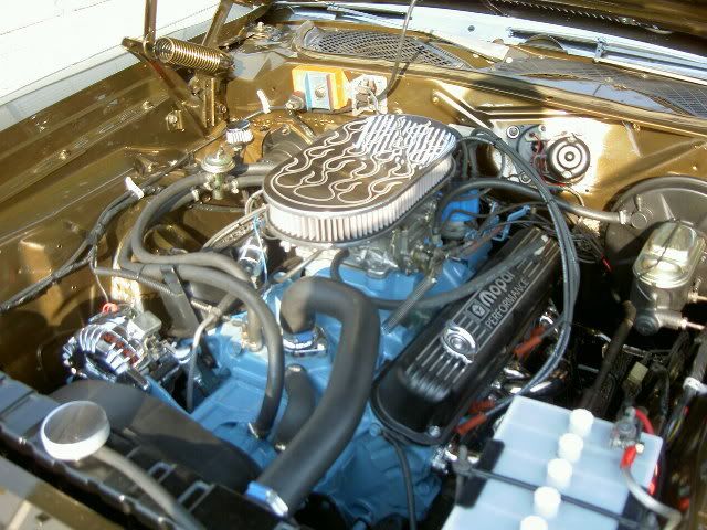

the engine...
...with rebuilts and modified heads, new paint, and a lot of new parts...(in and out)...

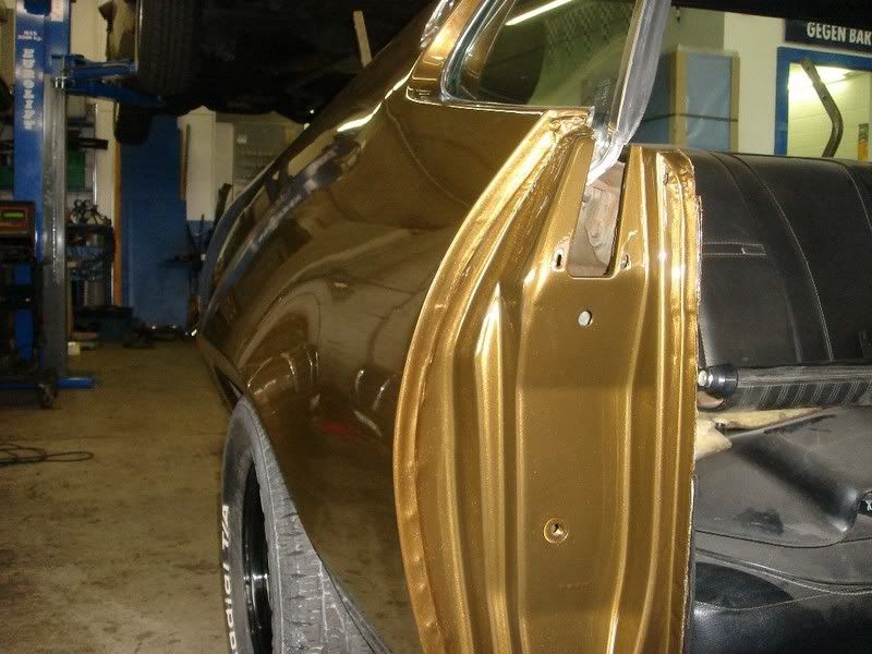

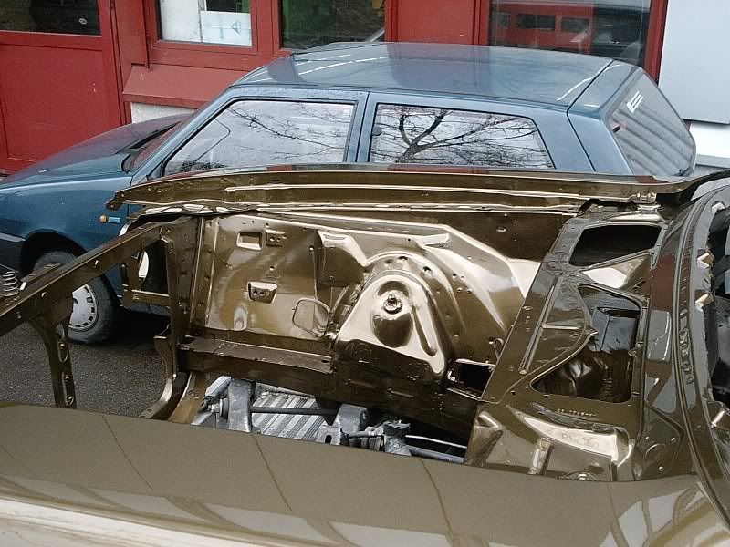

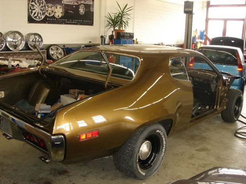

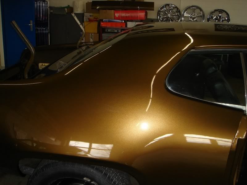

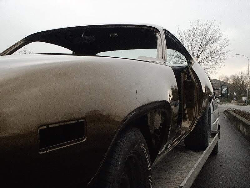

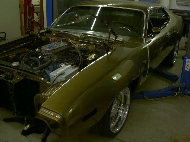

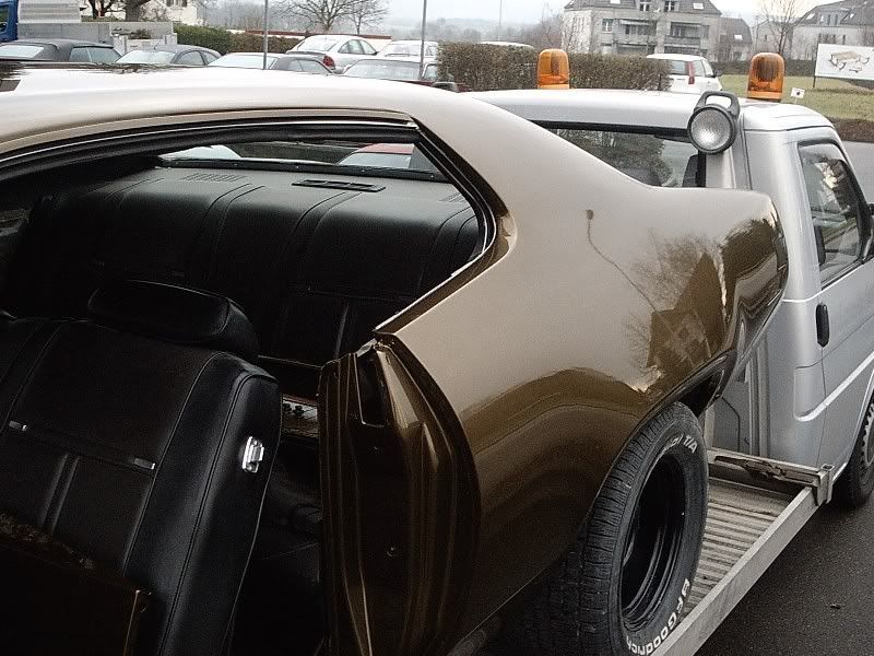

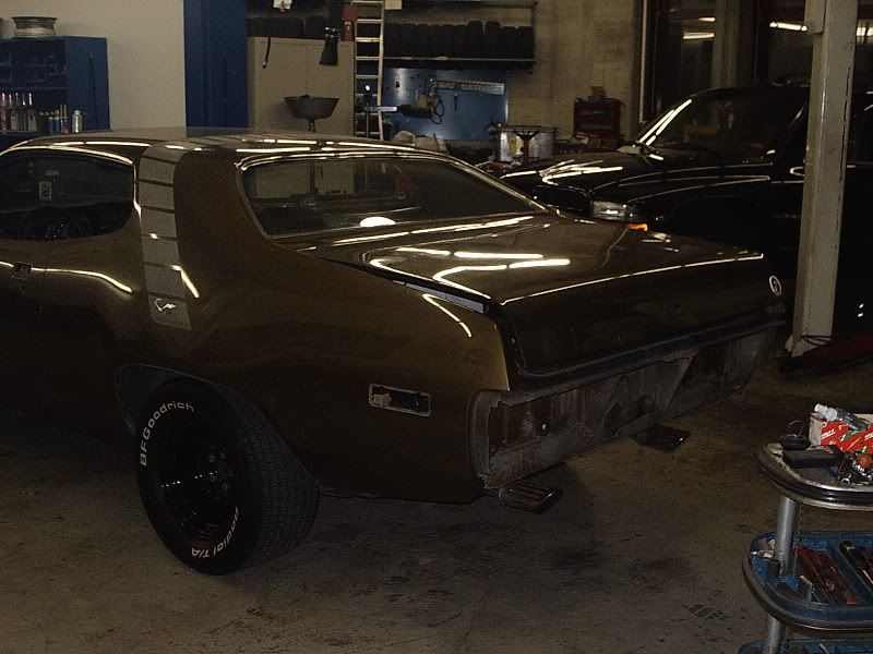

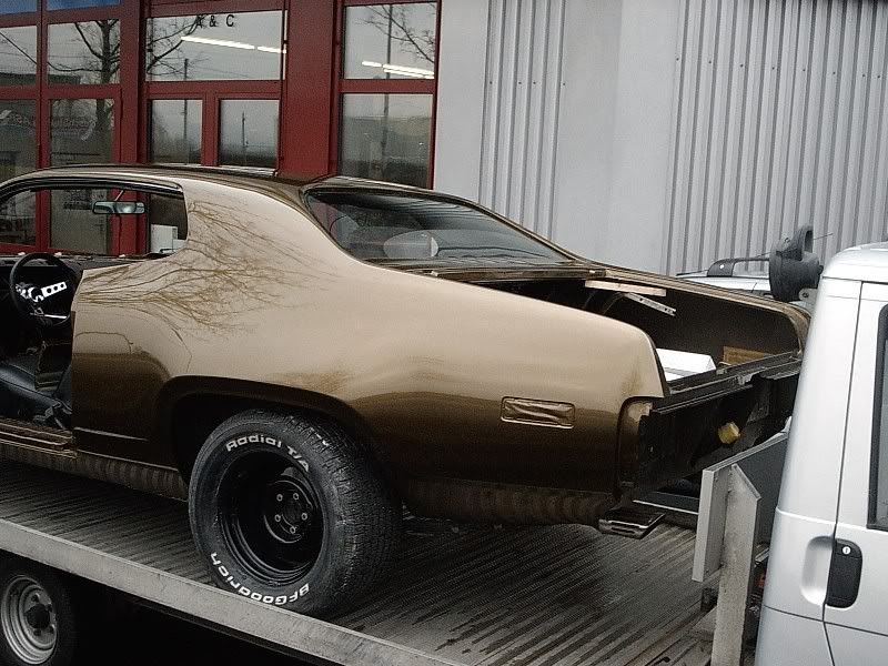

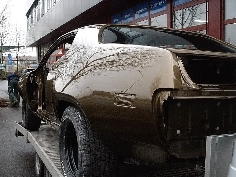

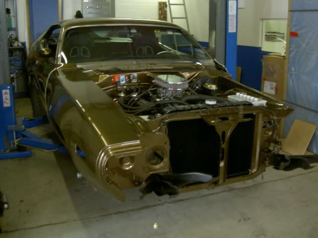

in same time, the body was ready for paintjob....
and after 3 weeks...the RR cames back with the new paint... 8) (original GY9 tawny-gold metallic...)

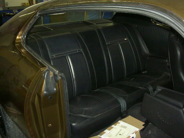

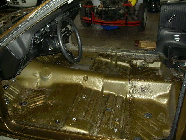

...and i start to assembly the car...

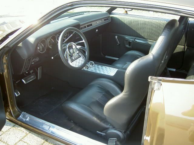

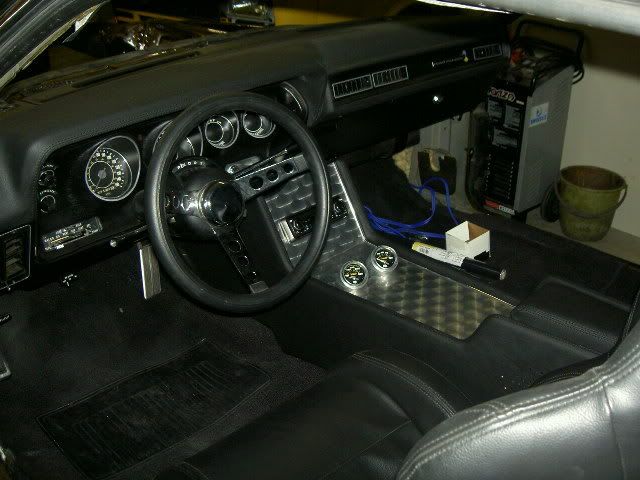

...and the "customizing" of the interior begins...

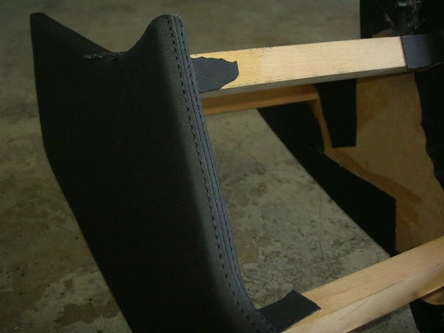

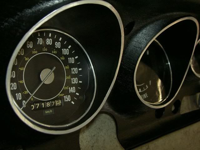

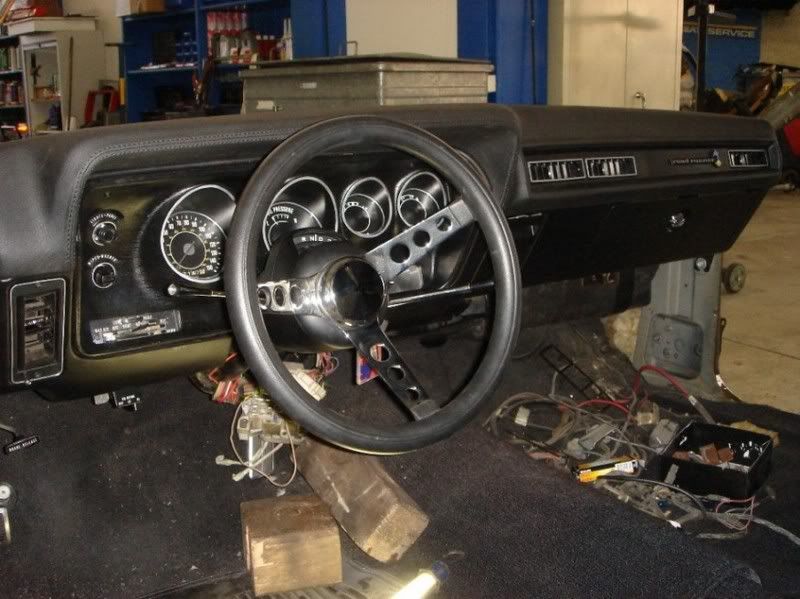

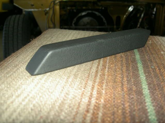

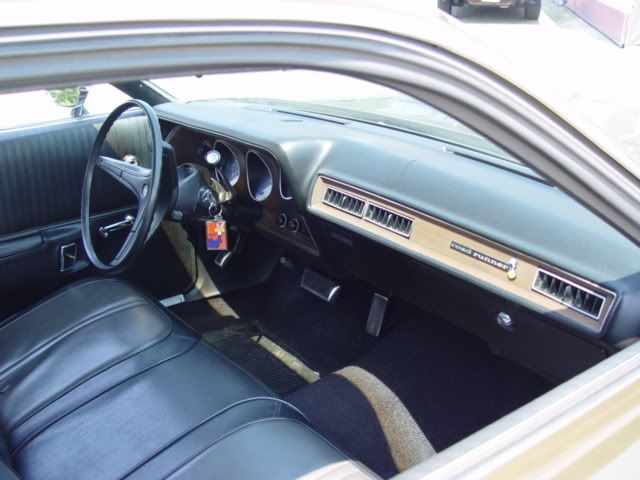

the dashpad was kracked...i repair it and cover it with fine black leather...

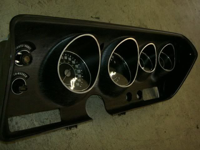

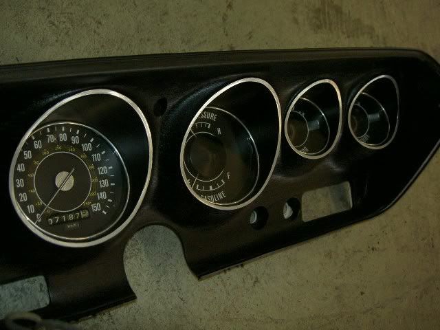

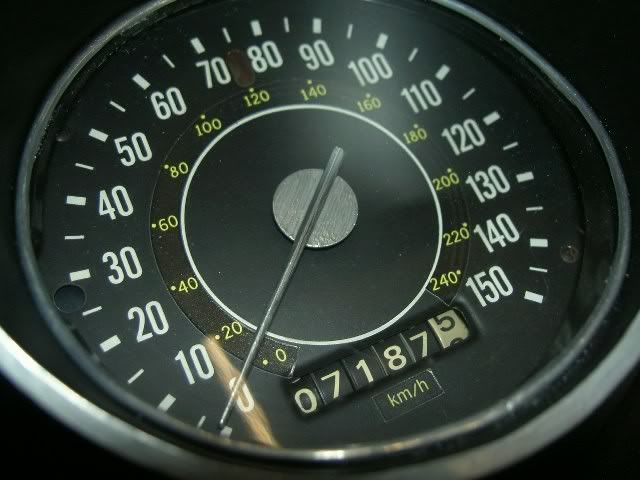

the rally-instruments are modified with black painted wood-inserts, fine aluminium rims in the instruments, km/h add., an other mods...
and then i mount all in the car...

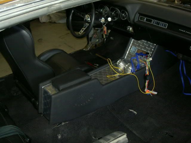

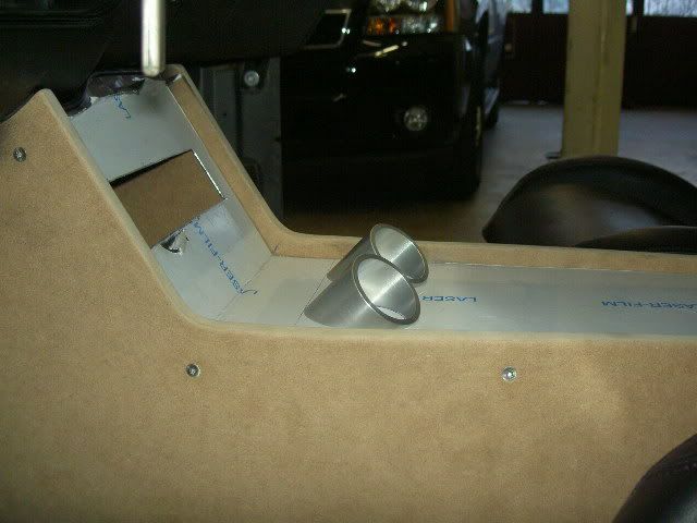

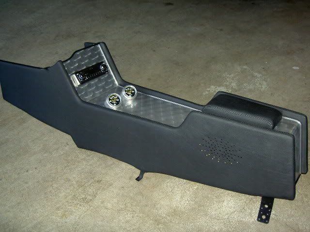

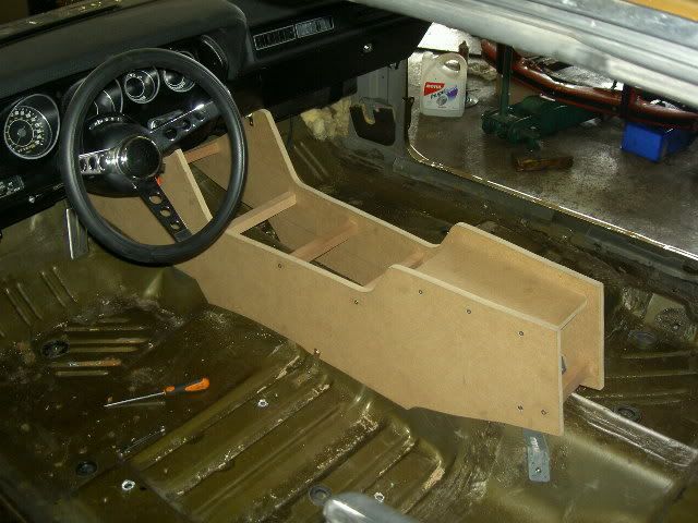

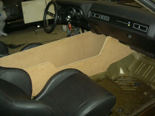

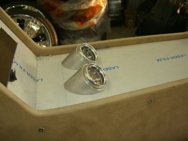

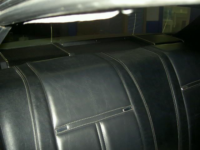

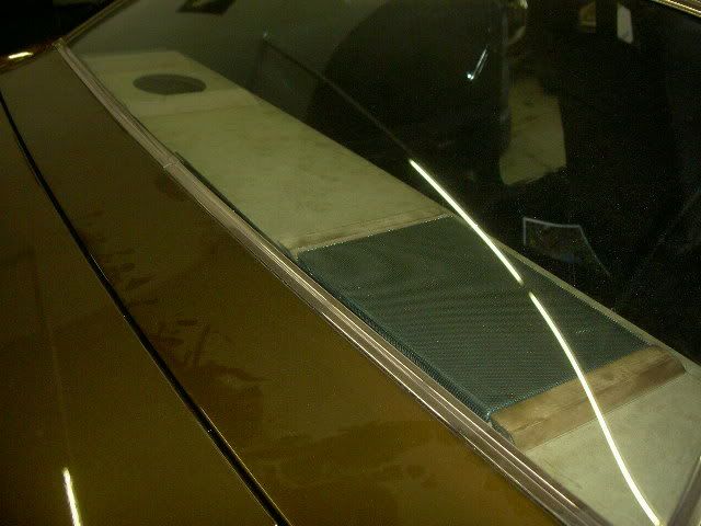

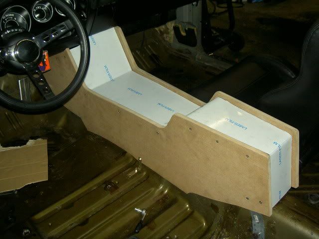

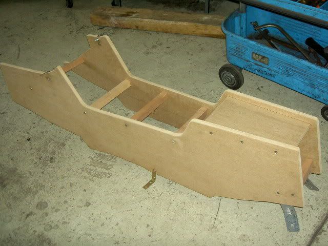

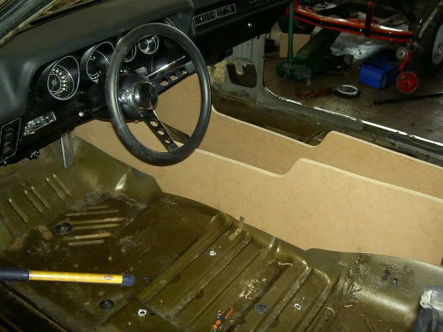

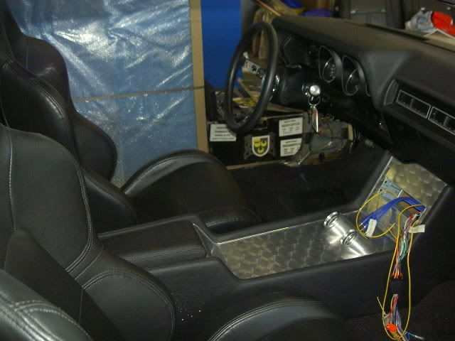

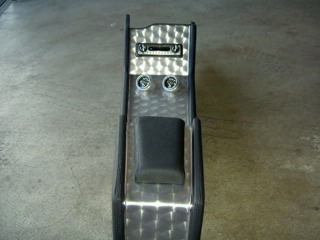

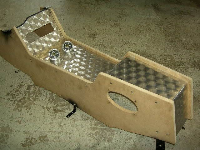

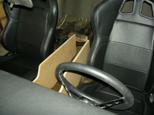

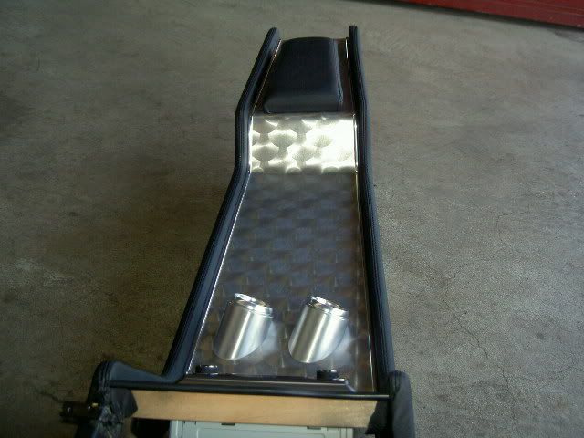

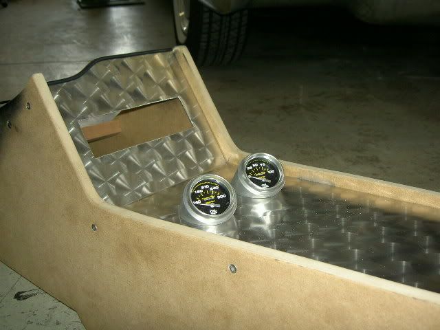

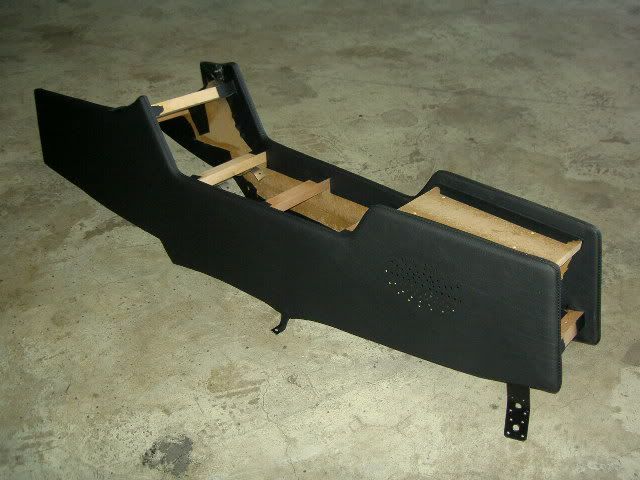

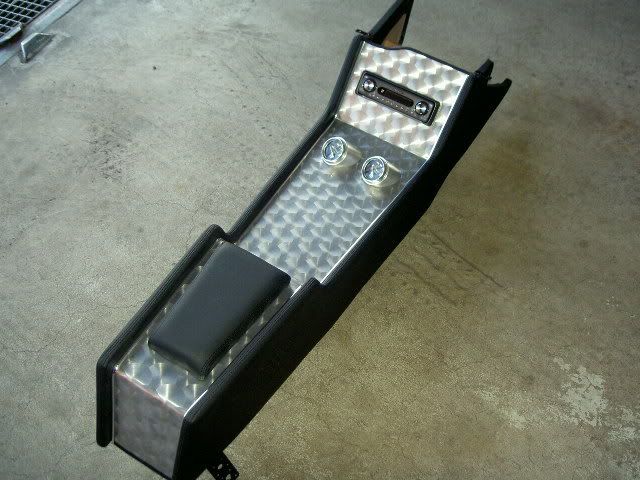

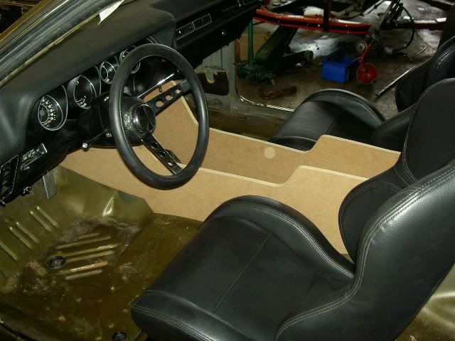

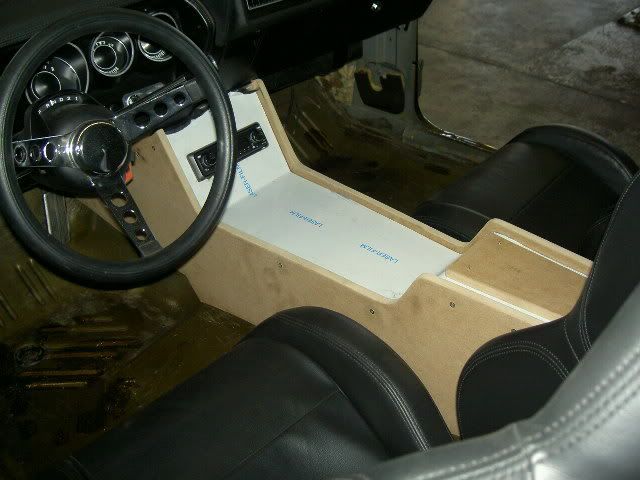

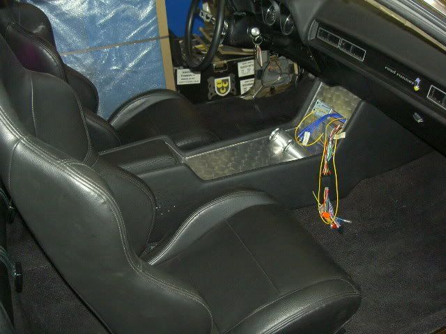

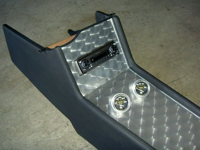

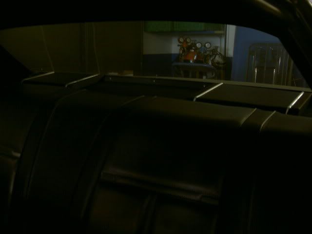

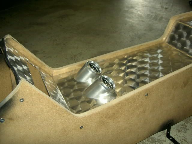

...then i weld supports for the new seats and begins with building a custom-console..

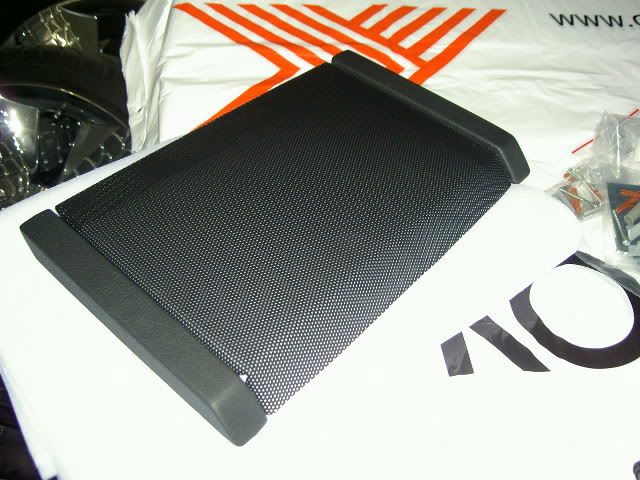

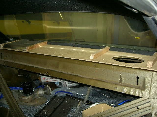

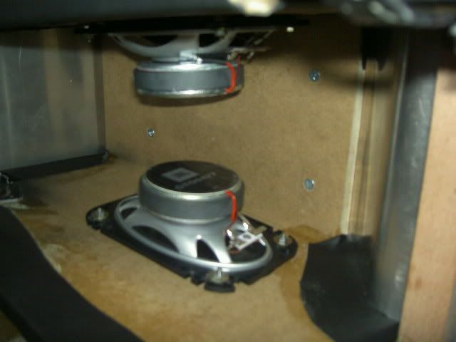

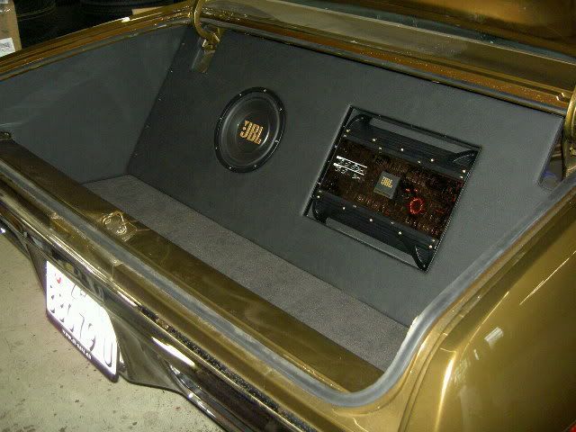

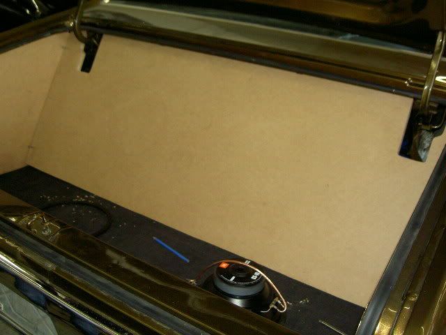

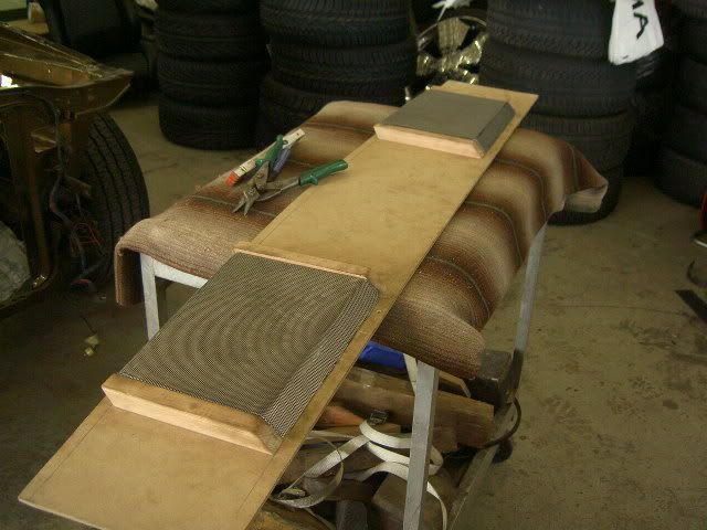

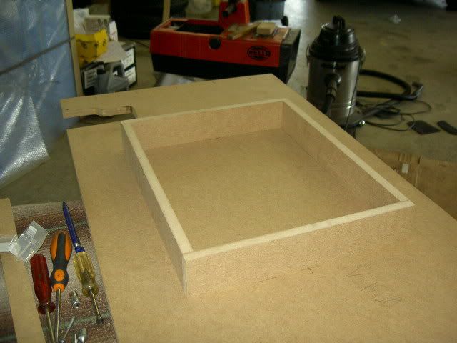

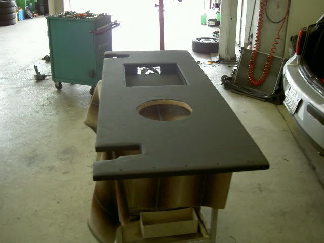

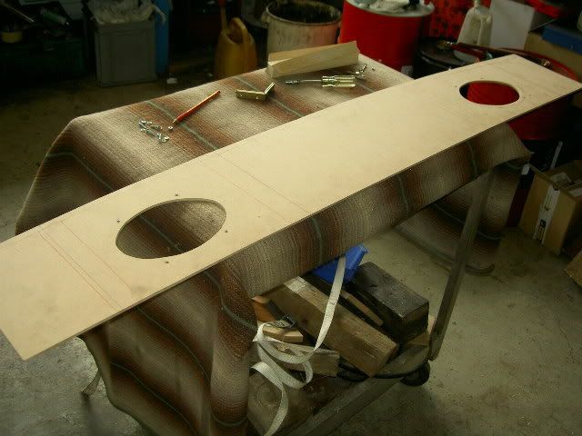

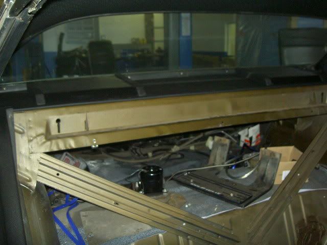

...then i build a soundboard with two jbl-5x7" speakers, and mounting the amplifier and subwoofer in trunk...
gionni
Posts: 178
Post by gionni » Mon May 14, 2007 11:00 am

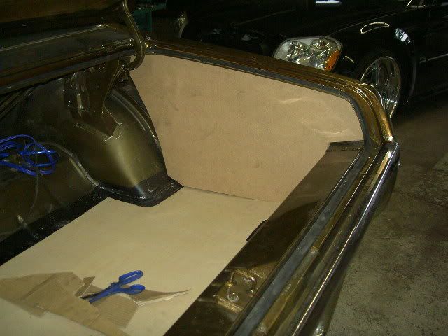

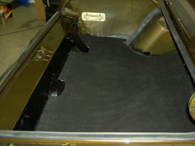

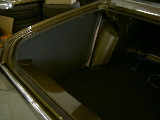

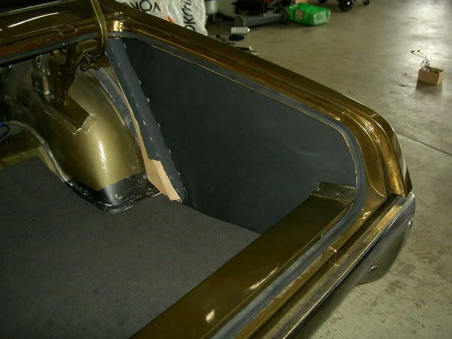

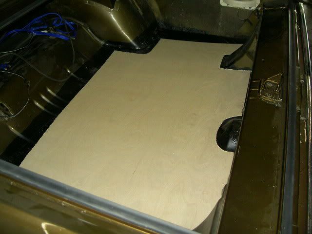

the trunk...

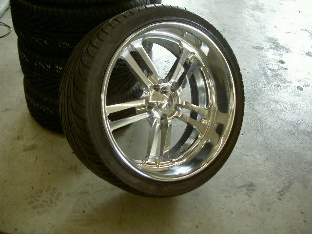

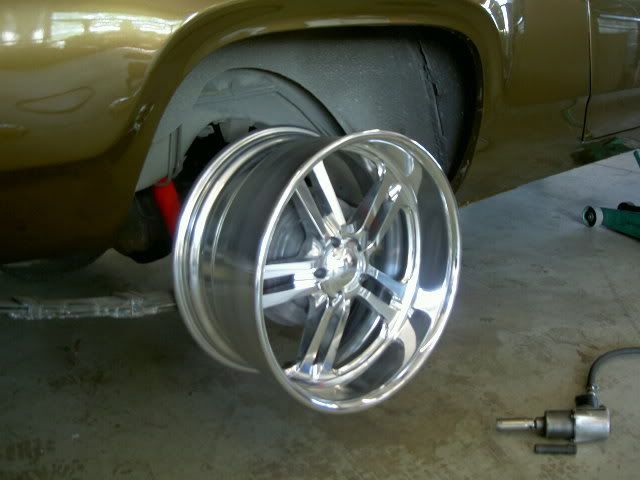

in the same time i recived my wheels...

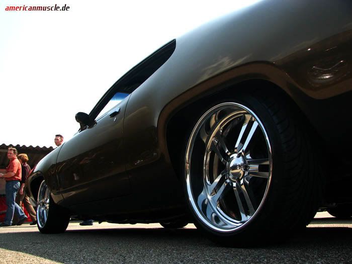

budnik's "ice" in front 8x19 on 235/35 ZR19 and back 10x20 on 285/30 ZR20!

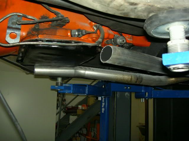

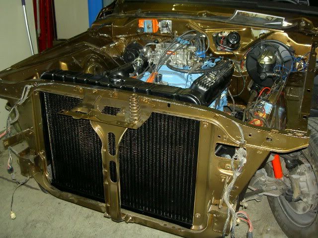

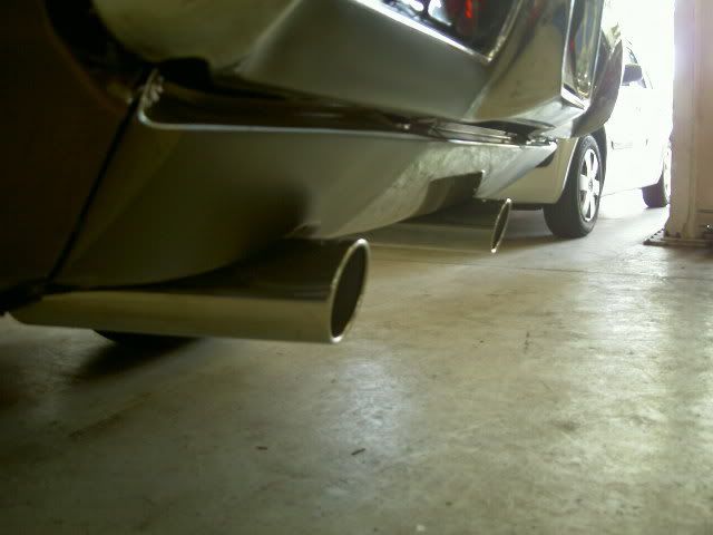

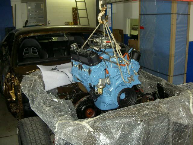

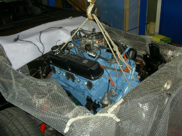

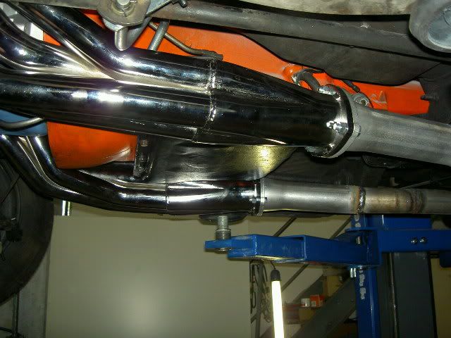

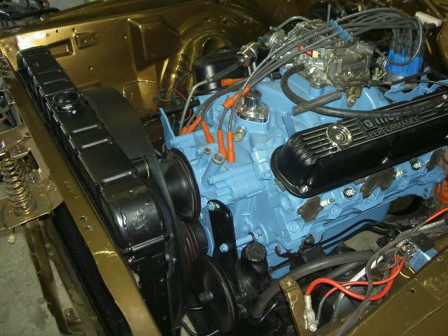

after a lot of weeks waiting, i recived from the states my new 11" converter with 2500RPM stall....and then i could mounting the engine...

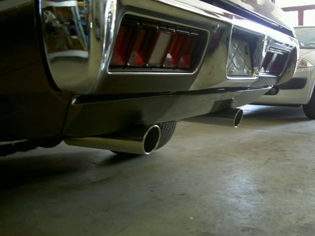

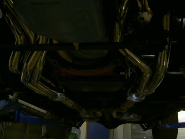

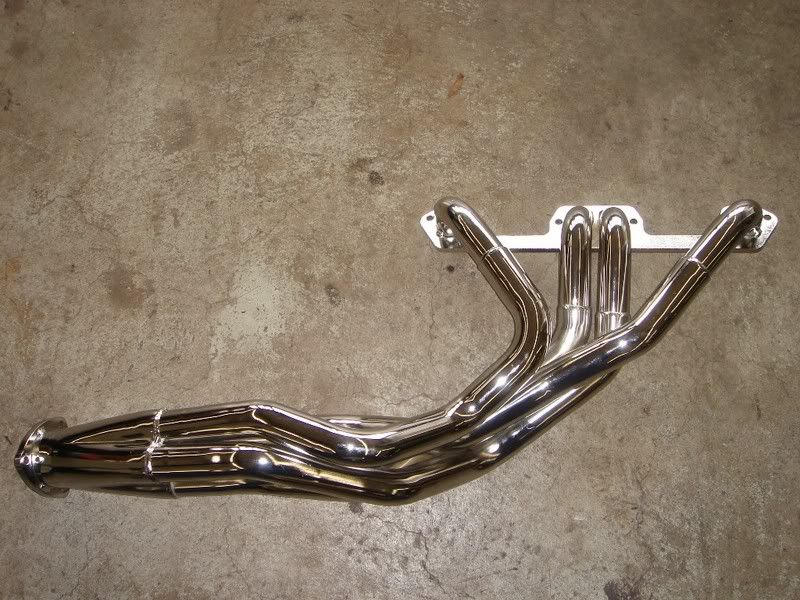

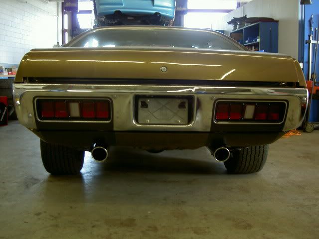

in the same time i mounted tti-headers and 4" magnaflow-tips (the rest of exhaust is 2.5" with H-pipe and dynomax mufflers)...

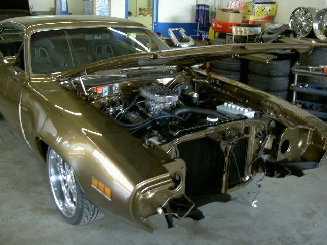

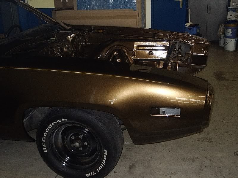

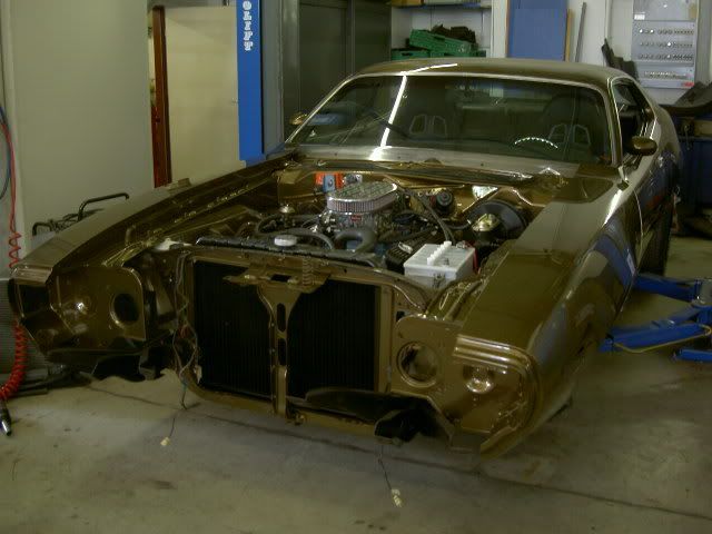

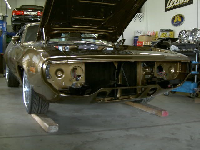

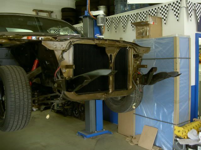

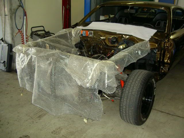

...and then complete to assembly the front fenders, hood, an the front...

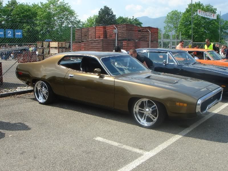

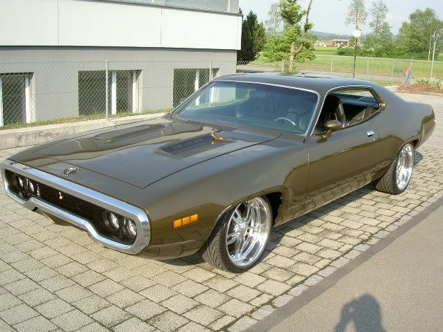

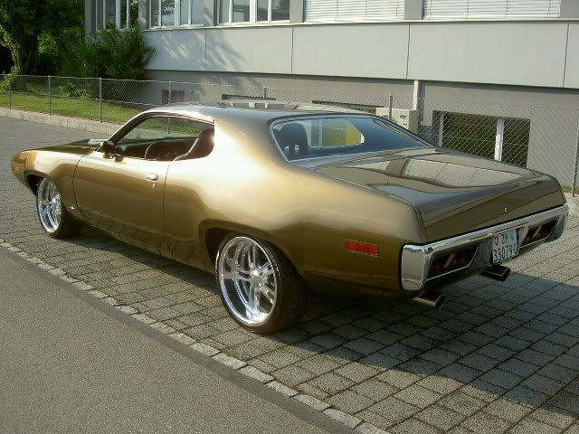

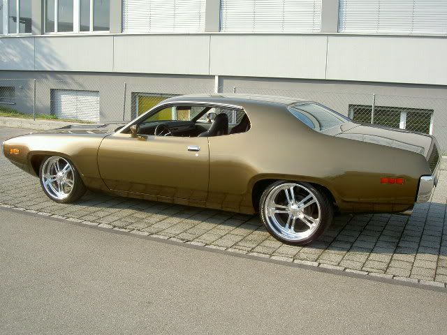

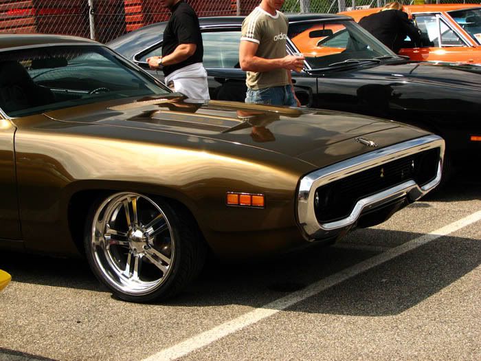

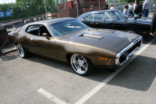

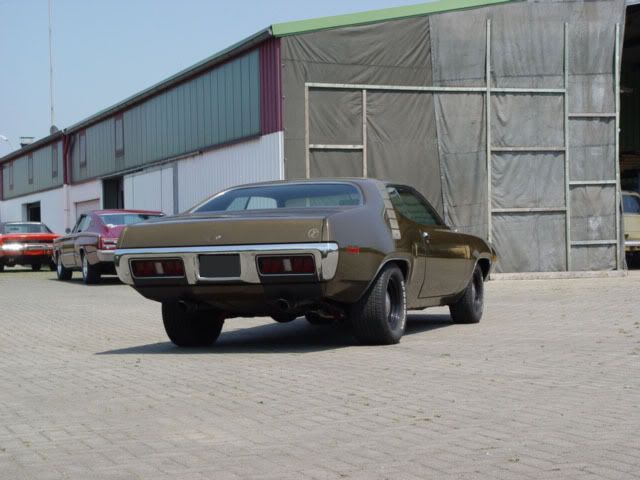

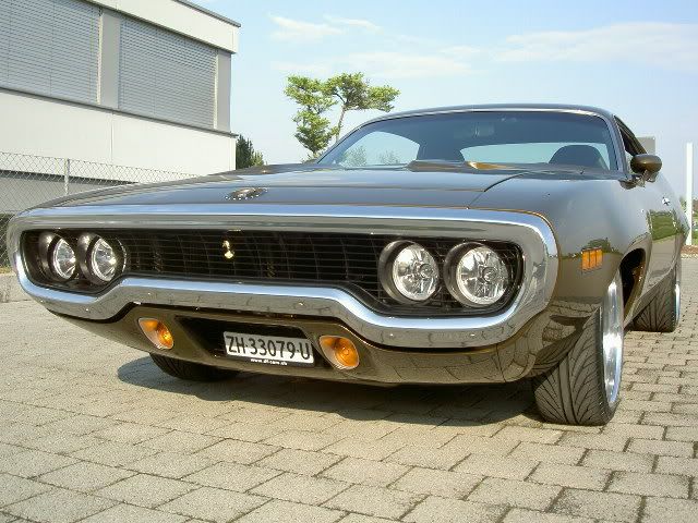

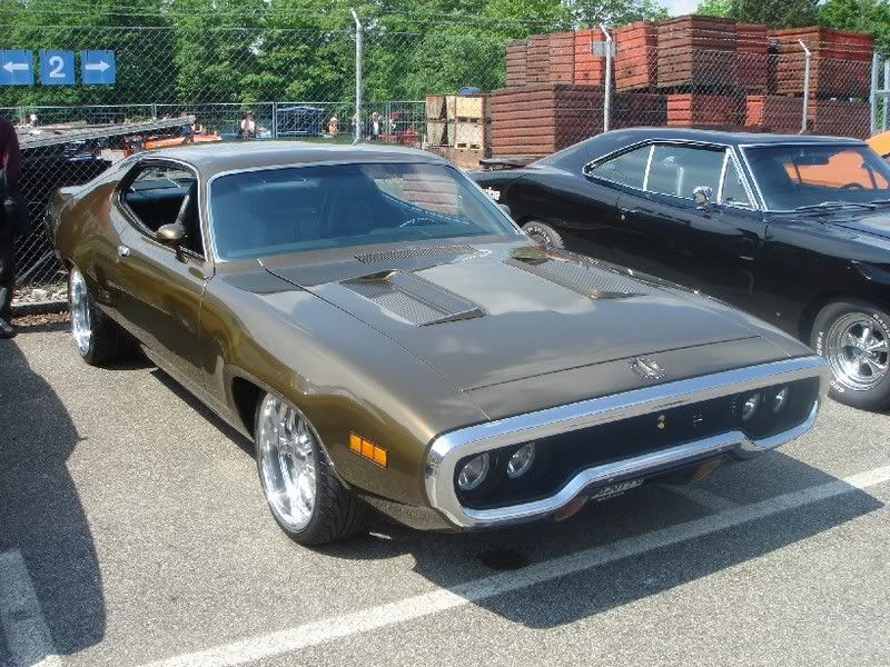

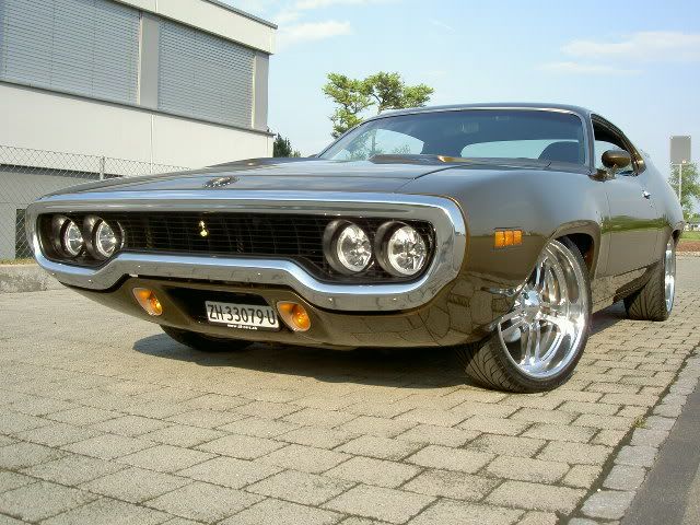

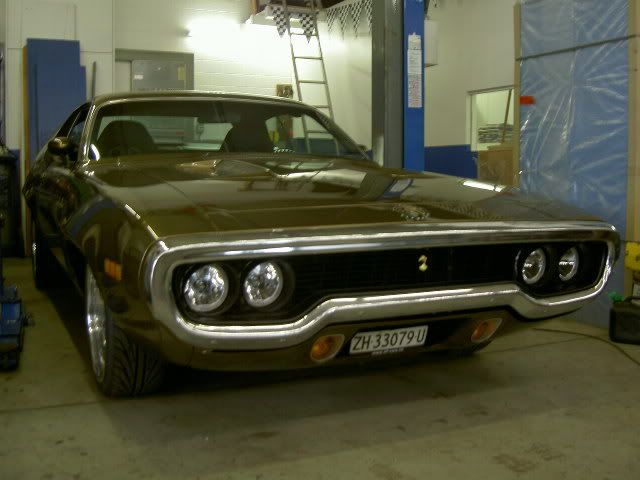

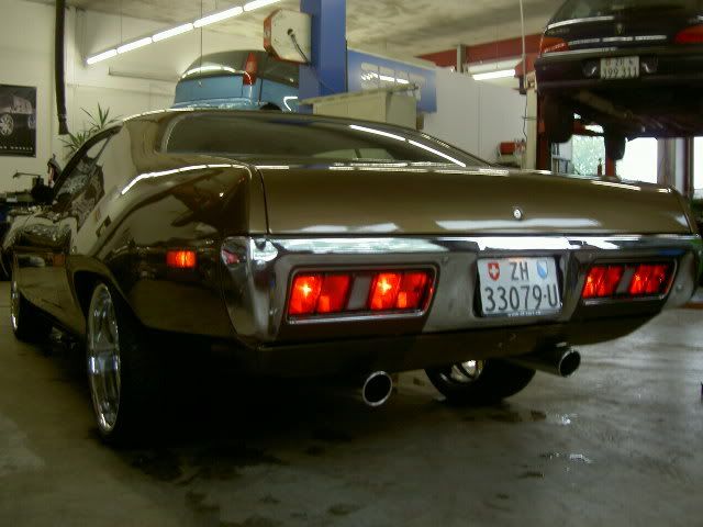

...and this is the "finally product"..
an last sunday i was with the RR at the first car show...

I really like the little modern touches, like the console and leather work. I'd love to see some posts explaining the details of how you leather wrapped the dash.
It looks like there are some really sweet Mopars overseas, judging by the stuff I could see in the car show pics.
