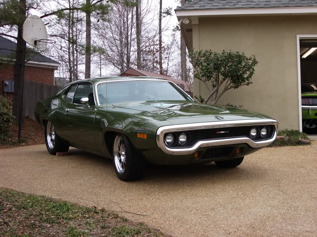

in progress
some wheels from a magnum.

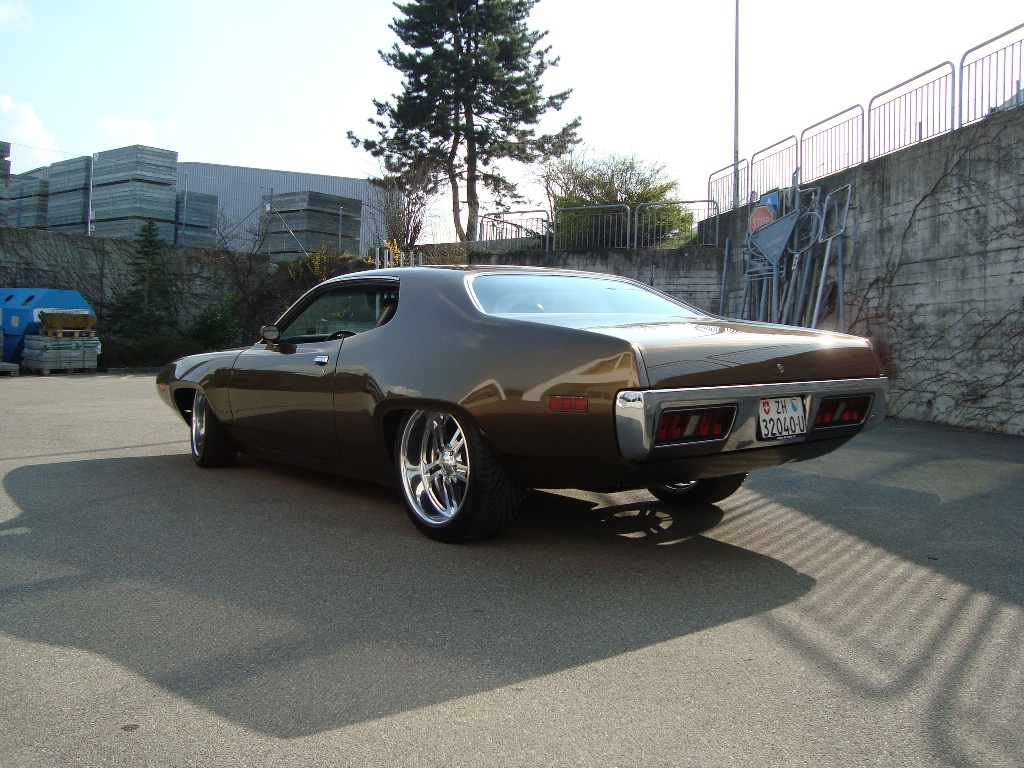

my RR has 19x8 on 245/40-19 and 20x10 on 275/40-20, all with offset 7mm...and no body mods...

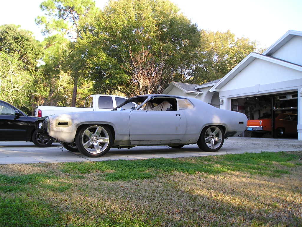

rmj wrote:Back from the dead! This is a REALLY old pic. 18x8 and 20x8 Centerlines. I don't remember the front tire size, but the rear is 265/50/20 BFG KDW 2's .
Gionni, back before your airride, did you have your springs moved in to hold the 20x10's?
These are pretty close to the springs now.

wow, nice satellite man! do you have more pics?
no, i never moved the springs in...the 20x10 mit 7mm offset fits without mods on springs or on body! :wink:
