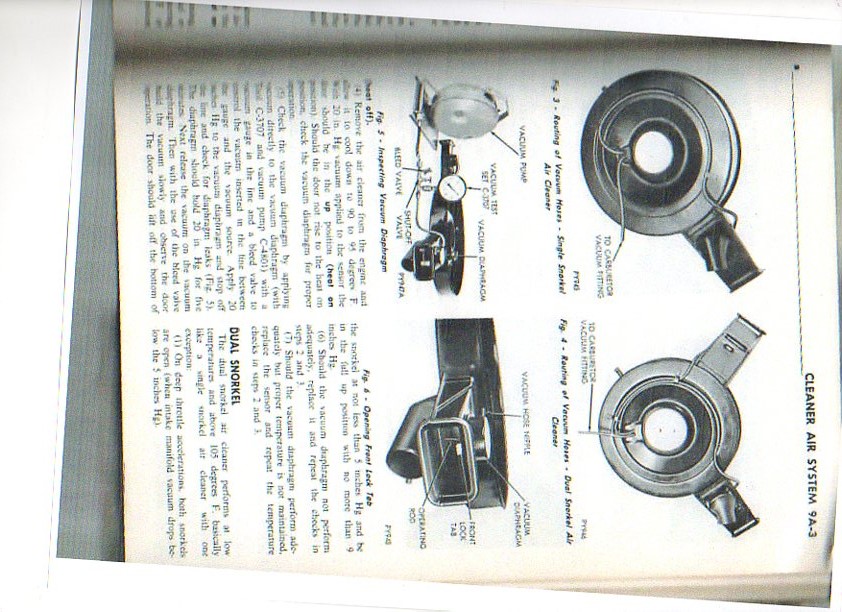

Hey guys, does anyone know where I can find the hose routing for the dual snorkel air cleaner,I have a Holley carb 4160.I have the triple nipple valve cover vent also. Thanks.

1971Chassis service manual
I hope this helps.
