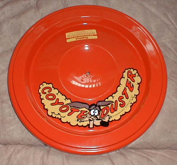

7,Does the air cleaner lid have a "pie pan" to identify the engine?

7 On AG cars - they don't use a pie tin to ID the engine. If you use a single 4 bbl there is a decal that goes on the open element lid. Coyote duster. There is also a seperate decals for the big oval AG Aircleaner.

Here's a photo of a 71 AG 4bbl air cleaner top, I assume the 72 would be the same.
