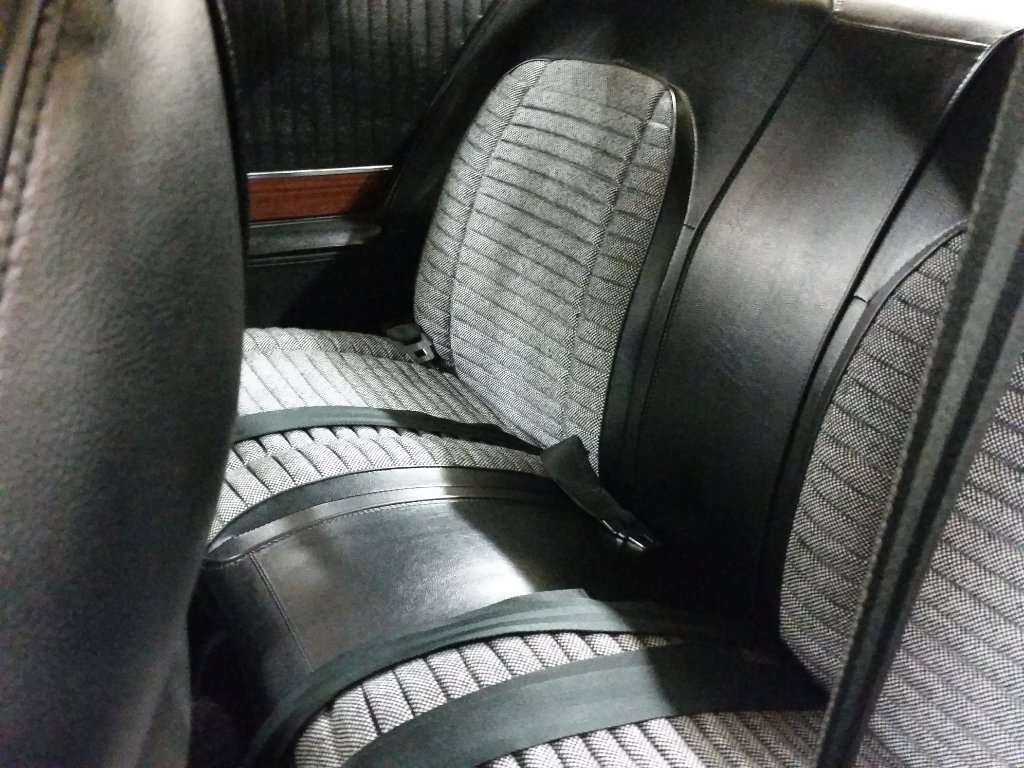

I think my front seats are not white and black, but grey and black.
Like these.....

Sorry it took me so long to get back. Here are the bottom seat frame pics. Also - I thing the grey and black is just an optical illusion - they are likely white and black with the black overpowering the white to make it look grey.

I think you are correct on the color thing - but Legendary is sending me a sample of it to see if it will match my front seats.
