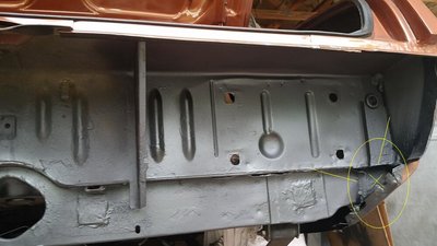

After installing mini tubs, i have decided to replace the trunk floor and extensions after all. My floor really ain't too bad, but the extensions are nearly gone from underneath. I bought all my pieces from AMD...floor, extensions and trunk extension end caps (as they are referred to).
My question is, where are these end cap located?? I do not see them on my car (probably because they rotted away ages ago). Neither my 71 or 72 Body service manuals show an exploded view of the trunks sheet metal components. Maybe someone has a diagram in a parts book??

can you post a picture of the part?

pic of the right rear of my 71 GTX with bumper and rear valance removed. Area circled in yellow, with x marks the spot for the end cap.

Thanx 71_bronze_gtx !!!
