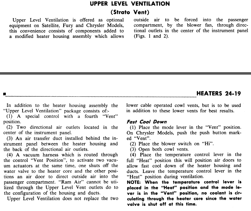

As I read the service manual, if your controls have a "vent" position, you have "stratoventilation", which appears to be an option separate from A/C. Without A/C, it is definitely an option.
Stratoventilation has an actuator to route un-heated and un-cooled air to the dash registers. It sounds like your actuator is stuck open, or not able to completely close. Could be the control, or could be the actuator. I'm attaching an excerpt from the FSM as a picture.
