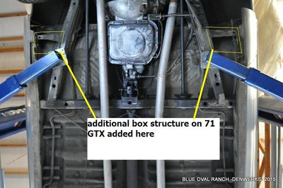

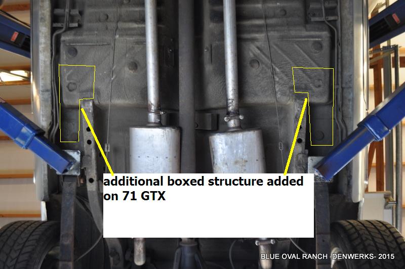

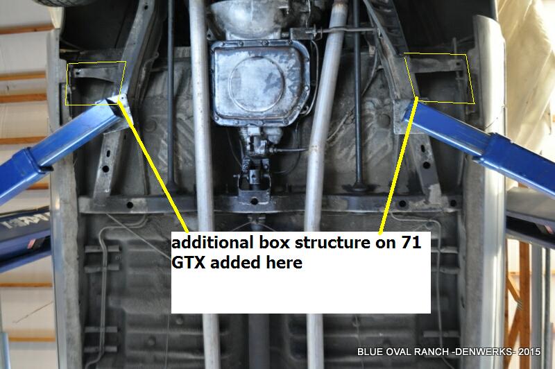

While searching for a good photo of a 71 undercarriage I came across an expired ebay listing for a 72 SSP. In pix of the bottom, I noticed that some structural boxing that is on my 71 GTX is not on this 318 72 SSP. I'm wondering if these were added for high performance engines to stiffen the chassis, or were they on all 71 cars and deleted for 1972?

They are for high performance and are call "torque boxes" so the torque from the engine doesn't flex or twist the body. They're welded to the four corners of the under carriage. I installed them on my car

Thanks. As I suspected. In my case, the forward perch for the leaf springs is bolted to this "box". For this SSP in the pix, there must be tubing or channel subframe sections obscured by the lift pads which the perches are bolted to, which suggests the torque boxes are a substitute rather than add-on - at least in the rear. Hmm.

That's OK - it's pretty clear to me - I've been under there looking at this stuff for a month. In the rear box on the passenger side, I looked inside with a borescope, then reached inside as best I could to scrape off loose undercoat, made a small hose attachment for my shop vac to suck out all the debris, masked off the perch mounting bolts, and filled that sucker up with Eastwood internal frame coating, along with the rest of the subframe members between wheel wells. No real access to the front torque box or transverse frames to scrape, so I just overdosed them with coating inside.
What got my attention in the 318 Satellite pix was the absence of the torque boxes and the fact that tubular subframe members were there instead. In the rear, they hold the perches, and in the front I suppose they stiffen the rocker structure where the fenders are bolted on.

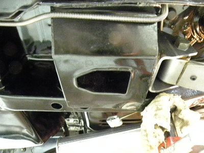

Maybe I can get a picture of mine in the rear. My car is black, so I don't know if a picture will turn out, but I'll try.

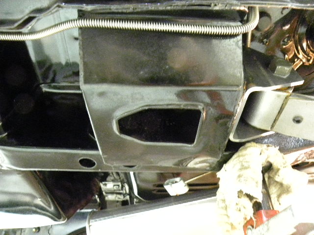

These are the best I can do. Also there are different companies that make these thins and they may look different. There is a year difference between 71/71 and older B body plates. This is the front.

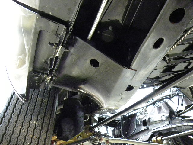

Re: Chassis Subframe Differences 71 vs. 72?
Rear. I hope it helps. I didn't install them. These particular boxes didn't come with the lip around the access hole, so the body man made those lips cause they had them from the factory.
