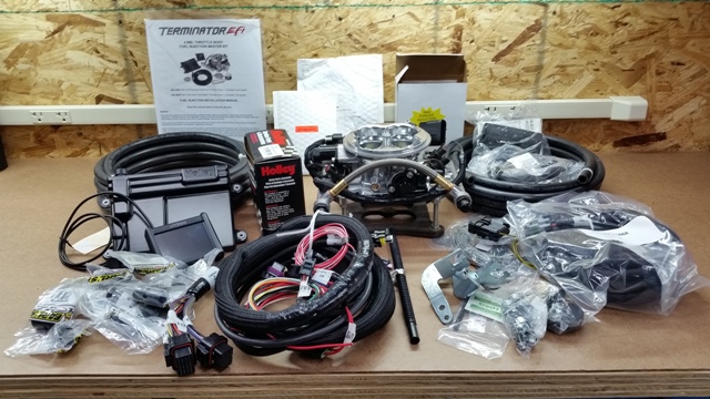

Here's the "big picture" of the entire kit laid out.

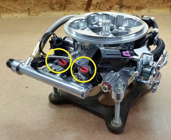

The injectors aren't actually "on top" of the Terminator as they were on the Dominator system. They come in horizontally, two from the front, two from the back, and are just below the throttle plates themselves. They're circled in this image.

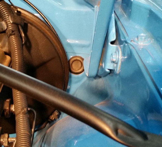

The “mystery hole” was used primarily for various optional equipment, factory and dealer installed. Installed many factory retrofit cruise control kits that incorporated a molded grommet on the harness sized for that hole back in the day. On the Dodge side, vacuum hoses or wiring for concealed headlamps used that hole.
Re: Holley Terminator EFI
I figured it was something like that, but nothing in my FSM or parts manual referred to it. For the Keisler transmission I used the clutch rod hole to run the wiring harness to the ECU.72RoadRunnerGTX wrote:The “mystery hole” was used primarily for various optional equipment, factory and dealer installed. Installed many factory retrofit cruise control kits that incorporated a molded grommet on the harness sized for that hole back in the day. On the Dodge side, vacuum hoses or wiring for concealed headlamps used that hole.
One thing for sure...I was not going to "cut" any of the firewall. Had that been the only option, the EFI would have gone back to Holley.

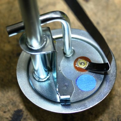

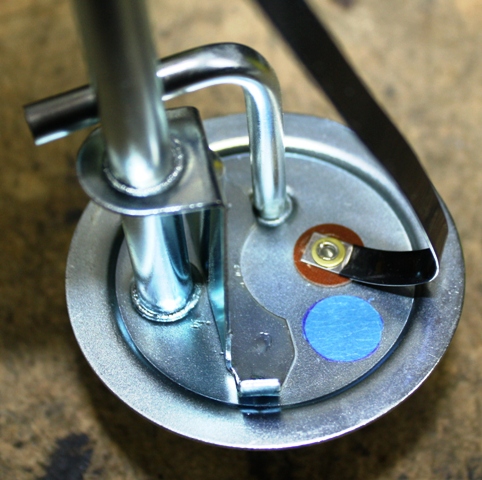

Return line follow up. I investigated replacing the 1/4 inch tube with a 3/8 inch, but due to the sending unit electrical binding post being plastic, any welding/soldering would generate too much heat on the metal. Plus you can’t remove the binding post as it’s riveted in place, and I can’t seem to find one that might bolt in.dangina wrote:I can't wait to see those pics! Is there alot of wiring that you have to do or is it just for the ecu? I like that the injectors are ontop, looks like it should be a easy bolt in solution. Was this $500 off a black friday sale? I may just pick one up next winter...
Image shows the only place big enough for the 9/16 inch hole (blue dot) for the fitting. Problem is the fitting has are two washer gaskets on both sides, and the one on this side would be on top of the support bracket, and the same with interference with the sending unit electrical connection.
So..... . I might just suck it up, and buy a new tank and weld a return line through the side of the tank. Easy and safe with a brand new tank! The one on the car is the original, and has a few dents in it anyhow. I can get one from Mopar Restoration Parts for about $170, which is a lot cheaper than I had thought they would be.

You may want to consider something like this(see pic). You can get a npt barb fitting to screw into the middle for the return line. You will have to make a hole in the tank though.
Thanks for the info. I had planned on using a metal fitting for sure, rather than the plastic one that comes with the kit.moparite wrote:You may want to consider something like this(see pic). You can get a npt barb fitting to screw into the middle for the return line. You will have to make a hole in the tank though.
