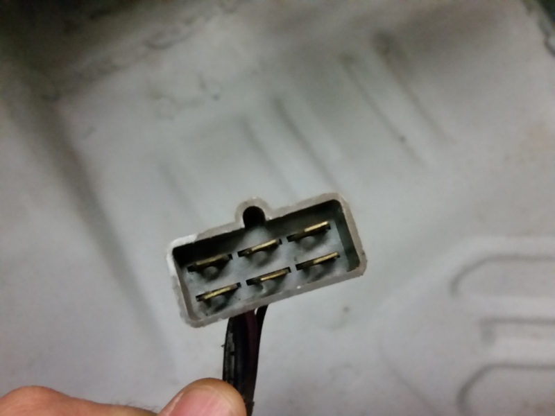

Rear body harness? Connects to the dash harness at the driver’s side kick panel, six way Packard connector, runs back to the rear bumper harness connector(4-way Molex), with split off for fuel tank sender and un-switched power for optional trunk light.

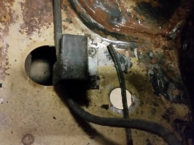

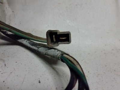

I assume this is the 6 way Packard connector you mention. But I also found this plug along with the 6 way connector. Any ideas? The interesting thing is the other end of that 2 connector plug..... Clean cut on the drivers side before the rear wheel housing.
Now when I bought this car it had a gear vendors overdrive unit in it that I had to give back to the previous owner. I don't remember if this 2 connector plug was part of that set-up.

Car had the rear seat speaker option, that's the wiring for it, has been cut off.
