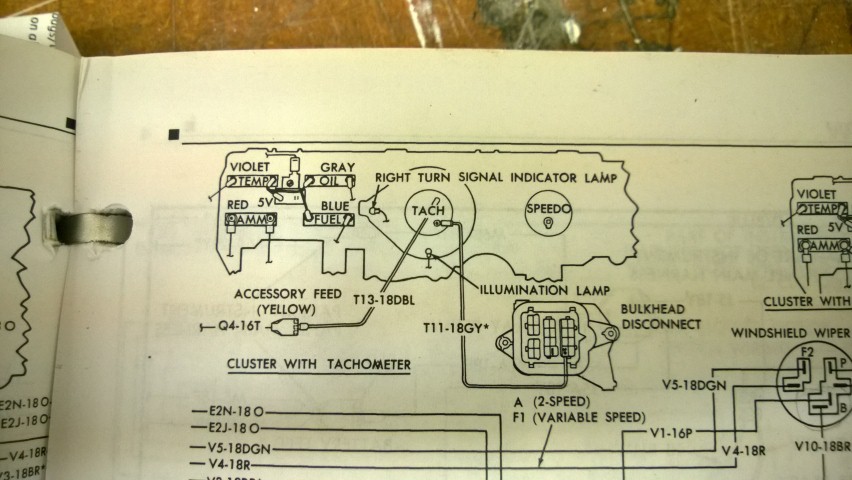

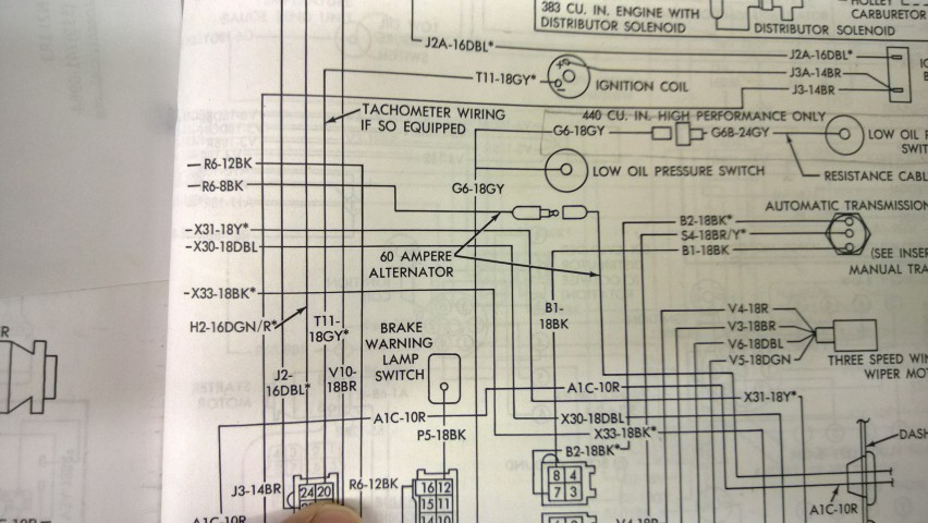

Here I got my son to take a picture. I'm posting two, one shows the wiring from the dash and other from the bulkhead connector on the engine side. My finger is pointing to it. Hope this helps.

general
Posts: 172
Re: Tachometer wire GTX 1971
Post by general » Fri Dec 18, 2015 5:13 pm
And the other
