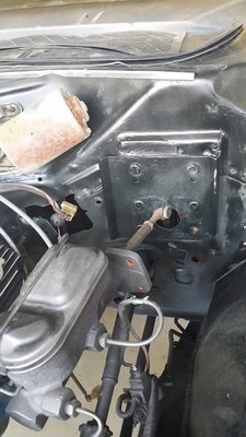

This is the plate on the car. Is it manual or power?

Re: Manual brakes to Power brakes quesion
That plate is neither. As in, that's not a stock plate. Your car has been modified, the bolt heads are a dead giveaway. You should either have studs that come through from the pedal mount on the other side of the firewall, or studs on the power booster. You should not have bolts in either case. On top of that, the stock plates have a rounded bend on the edge, it's not just a straight bend like on your plate. Sorry, while I have linkage on my Challenger that eventually I won't be using after I convert to manual disks, it's still on the car at the moment and I'm not ready to do the swap yet.mrsnicks wrote:Back on track.. Is the booster plate on there now for a manual or a power brake setup? Do I need to purchase a new plate?

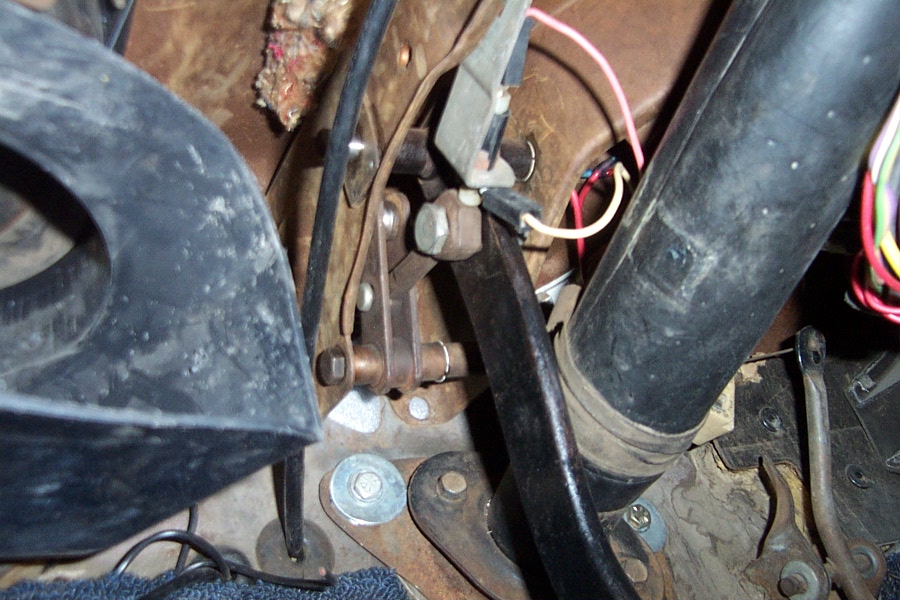

This is what a stock plate should look like...
Power brake plate
Manual brake plate
