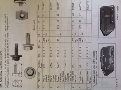

So i just bought this, http://www.ebay.com/itm/321530991365?_t ... EBIDX%3AIT , after replacing my inner fender.
Which end goes to the battery tray and which to the inner fender. It only comes with I speed nut/j clip.. What goes on the other end?
