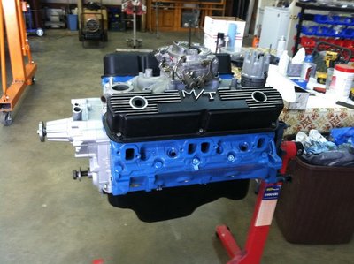

Re: Aluminum Radiators
Already sourced and rebuilt a 318. Will be an A/C car. Mild cam upgrade and 4bbl conversion.
