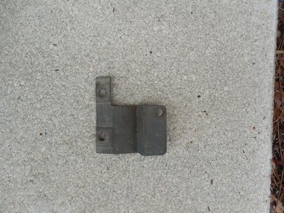

This piece?
Uses 2 speed/jnuts and bolts.

If that is the part that you are talking about, turn the picture 1/4 turn counter clockwise, put the end of the release rod through the single hole and the other two holes should line up with holes in the bumper. It attaches to the inside of the bumper.
