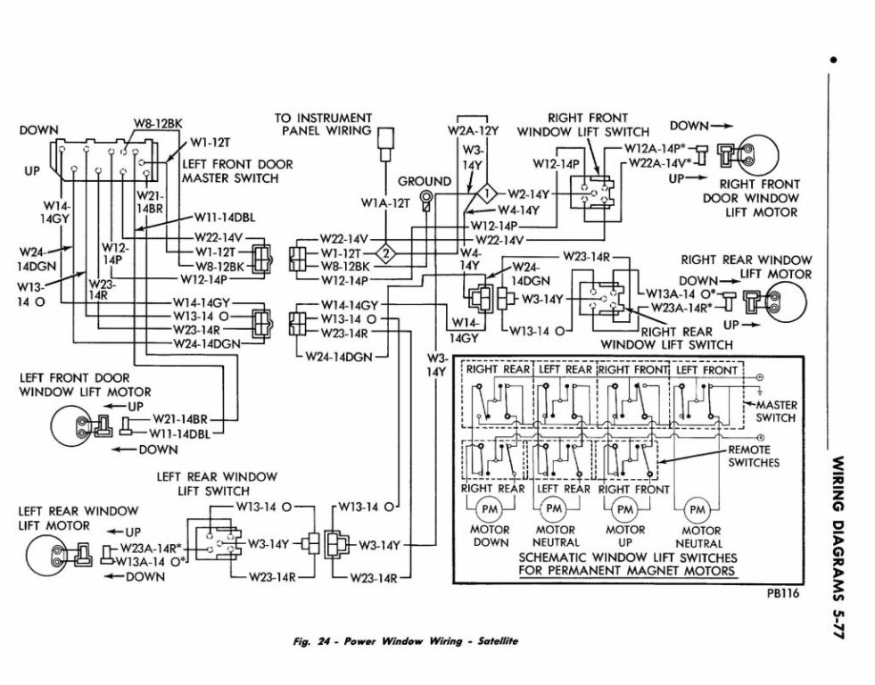

5) I have the option of getting a full set of power window motors out of the 73 runner. The owner wants to keep the windows in place, but I can pull the wiring, motors ect. Can I use my non power window regulators for this purpose or do I need to pull those out as well?
5a) when it comes to wiring, does anyone have the diagram on where the wiring goes or how power windows are wired? I do not have this option shown in my manual.

thanks! this is the best thing I have read so far on power window setups I dont have the keys to the cars mentioned, looks like aftermarket it isredline337 wrote:Quick Google search and I found this...

AWESOME!!! This is great! thanks for the help guys!71runnerm51 wrote:power window wiring

Regulators changed in ’73, fronts will interchange with ’71, rears won’t directly interchange. Can’t just remove the motors and mount them to the manual regulators, will need to swap out the regulators as well. On the front, the switches mount where the crank holes are, back of lower door panel is marked where the switch goes. In the rear, the switches go in the lower panel, again the location is indicated on the back of the lower panels. This will leave holes in the upper panel where the windows crank were, find a plug or original power window uppers without holes, good luck with that.
