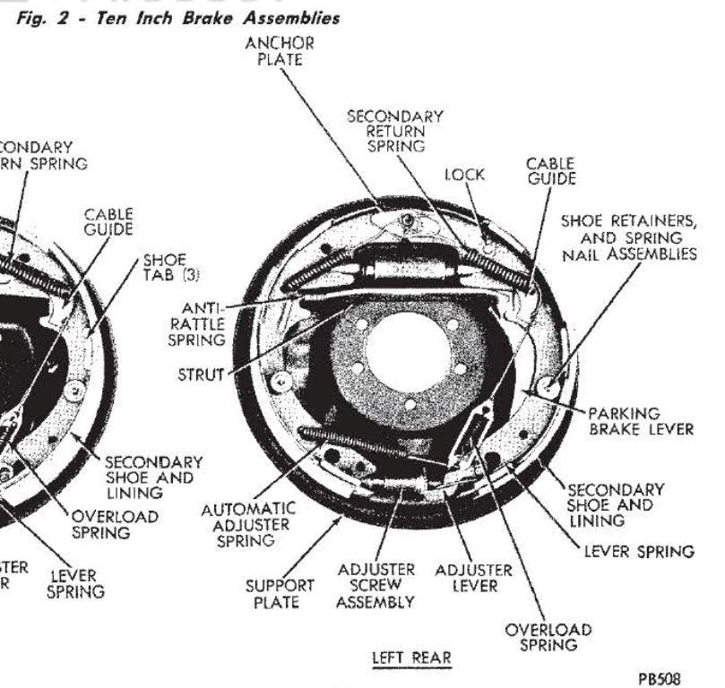

I need a good pic of the rear e- brake cable to brake shoe lever or how it hooks to the lever

pretty grainy shot from FSM but thought it may help. This shot is for 10-inch rear drums.

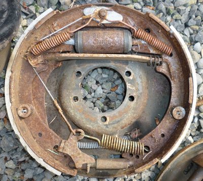

Maybe this will help...

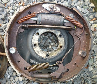

or this...

how does the cable hook into the groove ? just between the ball and spring?
71Satellite98661
Posts: 280
Joined: Sun Apr 21, 2013 7:14 pm
My Cars: 71 Satellite
70 Challenger
07 300C SRT8
13 Ram C/V (Caravan) work-issued
Location: Vancouver, WA
Re: emergency brake cable help
Post by 71Satellite98661 » Fri Apr 03, 2015 10:22 pm
Yes. Just pull the spring away from the ball end and voila!
