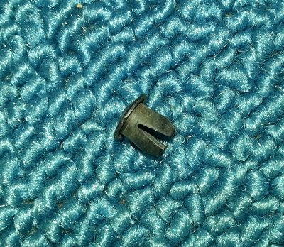

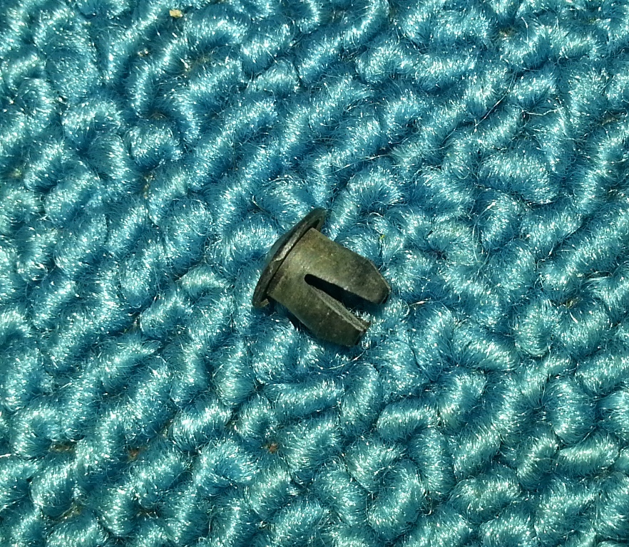

I plucked one from my car for you to reference...

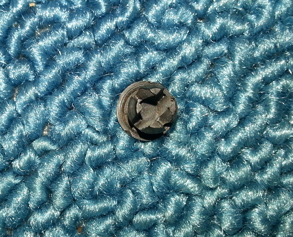

Post by 71Satellite98661 » Fri Apr 03, 2015 8:43 pm
fingers/spreaders to hold it in place

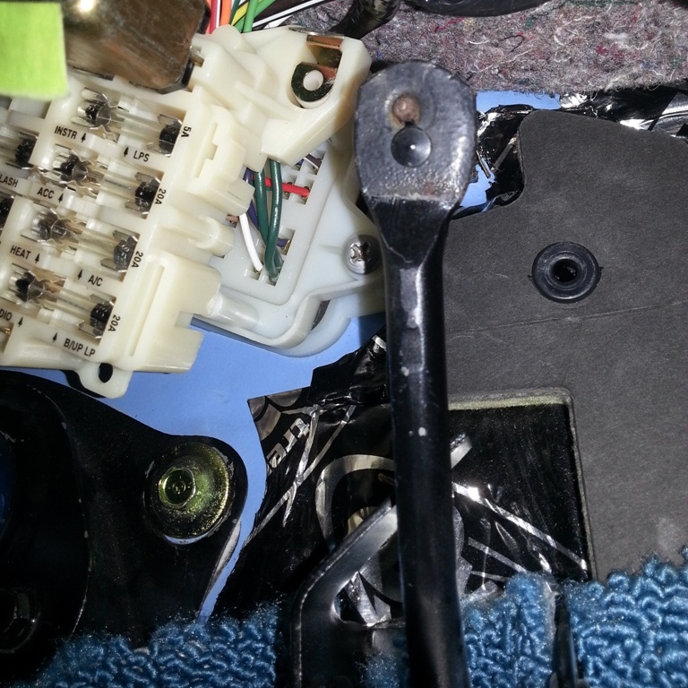

Re: gas pedal clip for throttle cable?
Post by 71Satellite98661 » Fri Apr 03, 2015 8:47 pm
here is a shot of the little bugger installed...
