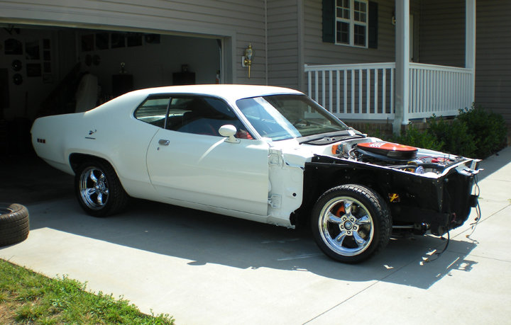

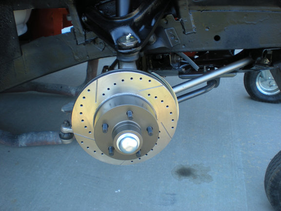

All F-Body stuff on mine. They work fine. The car now has the best brakes it's ever had.
Mine was a kit from US Car Tool and the drilled and slotted rotors are an option on the kit. In the second photo you can see the calipers that we powered coated orange.
