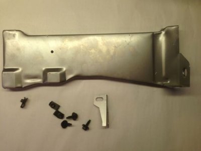

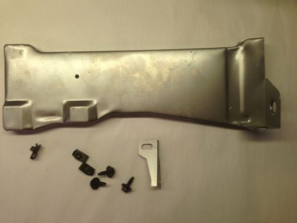

Post by Moparlar » Mon Sep 22, 2014 1:01 pm

Thank you very much for the link Moparlar! Fasinating stuff and can't imagine how rare those bottles are, especially the brackets. It seems there are (3) brackets total; (1) riveted to the bottle that overhangs the radiator, (1) to extend that bracket to the core support and (1) lower bracket that I still have yet to see.

Post by Moparlar » Tue Sep 23, 2014 2:46 pm
The bracket riveted to the bottle came that way when you got the bottle. Here is a link of repo brackets.
http://www.ebay.com/itm/1971-72-Dodge-C ... 44&vxp=mtr

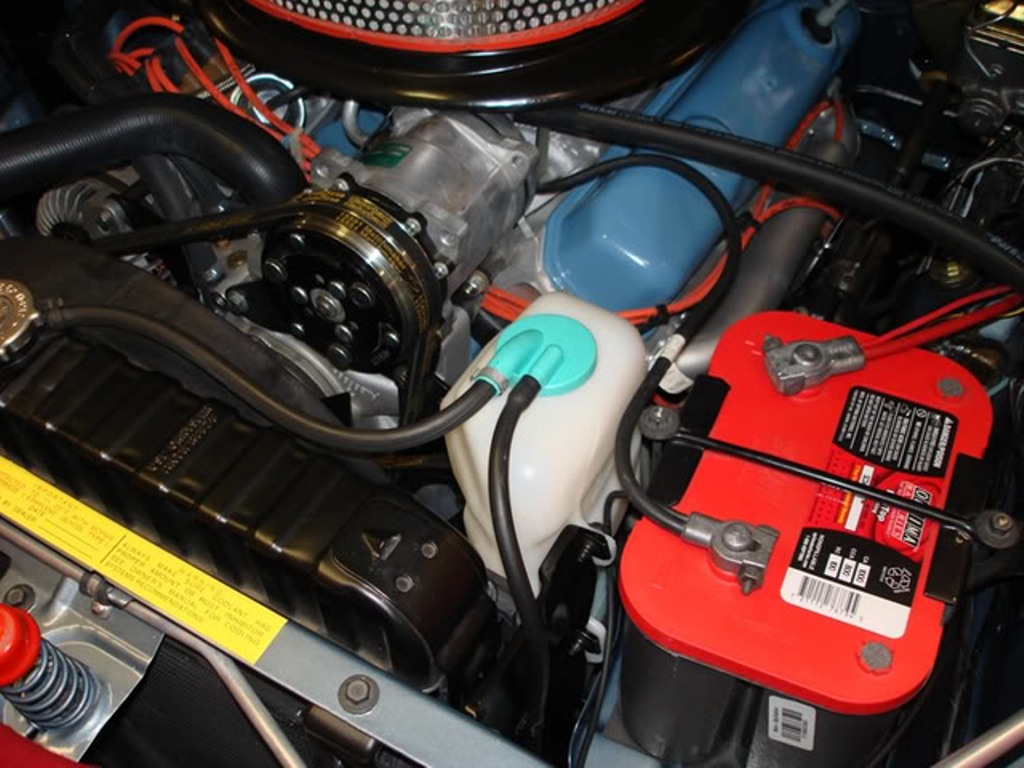

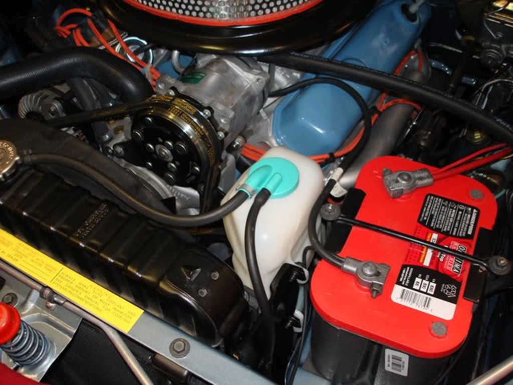

Post by 71Satellite98661 » Wed Sep 24, 2014 1:57 pm
Thanks for the link. The metal must be pretty rough if it is cast, I assume that is why he sprayed it with rubberized coating. Close as we can get I guess, kudos for that guy to go to that kind of trouble! I really like this set up that 72RoadRunnerGTX added to his car. There are (2) styles of aftermarket bottles out there right now. I'm not sure which one this is. The bracket doesn't quite look the same as the recent ones I've seen like from Classic Industries.
