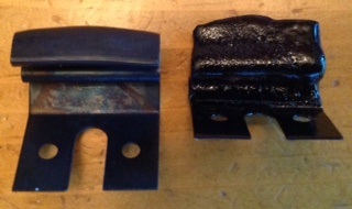

Posted: Fri Aug 08, 2014 10:56 pm
by 71Satellite98661
What do you guys think? Reproductions look correct?

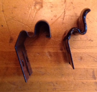

Posted: Fri Aug 08, 2014 10:58 pm
by 71Satellite98661
Side view

Look how much longer the flat side that fits into the channel , it will not fit just like the set i purchased and returned to mega parts but cant get them to process my refund although they said i could return them and i have tracking confirmation they received them, just get the "we have been so busy" email if they would process my refund it would take about the same amount of time as sending the lame email

71Satellite98661 wrote:What do you guys think? Reproductions look correct?
Looks like they are a little off. I would test fit them to see. If they don't work, it looks like you could easily modify them to make them work. Let us know how it goes! Scott.

New ones fit like a champ! With a bit of trimming on the squared off end (about an 1/8"), they snapped right in place. Here's the deal, I tried Plasti Dip on the new ones (the original dip version) and it was way too thick. I recommend the spray version. I actually ended up stripping the dipped version off with paint thinner before it set up and just painted them low gloss black. Granted, my door glass is not in yet and will have to follow up in that regard.

In addition to needing trimmed the top part is not shaped correct, even beside your broke one you can tell the first bend is wrong furthermore because they are not coated with the plastic stuff the orignals had and just metal that is plated black they will offer little in the way of anti-rattle for your glass and that is why they are on the car.
And sorry i did not mention the first time but you are correct if using the plastidip a few light coats of the spray version is what i did and worked well for me, didnt try the dip style.
