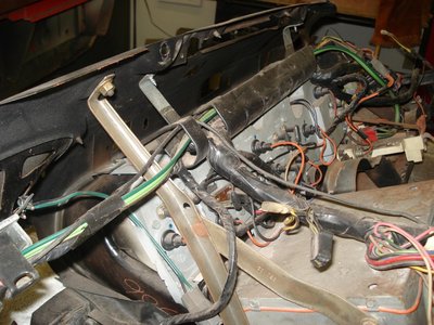

I am assembling an instrument panel from scratch and am foggy as to how the wiring and looms were routed and fastened. Don't ask me why but the body shop I took my 71 to decided to COMPLETELY disassemble the instrument panel and took no photos or notes. The HVAC components are pretty straight forward but where does this long rubber-dipped steel wiring trough (loom) mount? It has a a hold for a sheet metal screw on each end. Pictures would be a HUGE help, I am desperate!

Any photos would be great! This is a brand new harness too so it has no "memory".
Re: Advise and photos requested for back of instrument panel
this first one is from "general" here on the nest he has a couple albulms on this site showing a lot of nice work he did
this is a complete dash for sale on ebay if you look at the pics and use the ebay provided zoom you will be able to see how some of the parts are attached and routed

Oh man, that is great! Thanks guys. That shot of the bracket it the last of the puzzle. The instrument panel is back in the car and on the road again but will come out again in around 6 months or so. I buckled down and send off a core dash pad to Just Dashes for some fresh B5 blue! I am making due for now with one of those $100 plastic dash "caps". They actually look pretty good until it comes to the very right end of the passenger side woodgrain trim piece. The plastic isn't formed properly in this spot and holds the woodgrain out about 1/4 to 1/2". Hopefully the woodgrain doesn't stay like this and retain the bow!
