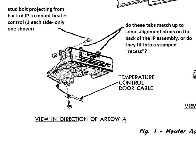

I'm trying to get the IP either rolled forward or pushed forward enough to get my non-working clock out and put a tach in.
Per the FSM, I have the six screws holding the IP removed. I have taken out the two nuts that secure the heater control head to the back of the IP.
However, the control head still seems to be firmly attached to the IP, which is preventing it from moving forward much.
See pic attached. Am I missing something still holding the control head in place?
Also, how is the speedo cable released from the speedo? Pull off? Twist off?

That really doesn't answer how to get the cable loose and how to get the heater control head separated.
Using my nifty new digital inspection camera (borescope), I saw that there is a retainer on the cable similar to what's found on electrical connectors, so assuming I can get my hand or some pliers in there, that one is solved.
Still studying what I saw around the control head - maybe a phillips screw with a clamp on the top side.
The FSM says to drop the column to get the IP out, but I'm not trying to get it out. If I can replace the gage without dropping the column, I will do it that way.

To further answer my own questions:
There are alignment pins protruding from the back of the cluster, and they fit very snuggly into the openings in the tabs on the top front of the heater control head. Once I got the control head pulled free, the cluster still doesn't move forward much more, and certainly not enough to get the clock out. The cluster at this point is rolled up against the top of the column.
So as advised, next is to unbolt the column from the dash supports and see if it will "drop" far enough to let the cluster roll forward enough to get at that clock.
For anyone - including me - who wants to install a new dash harness, it would appear that the smart thing to do is make all the connections to the cluster while the cluster is out. On a rat's nest like mine, it might be necessary to chop all the wiring to the cluster to get it out.
