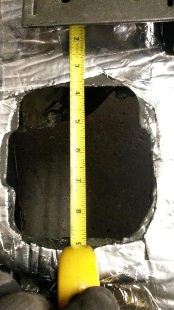

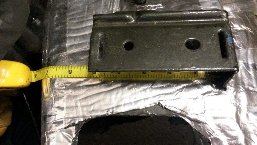

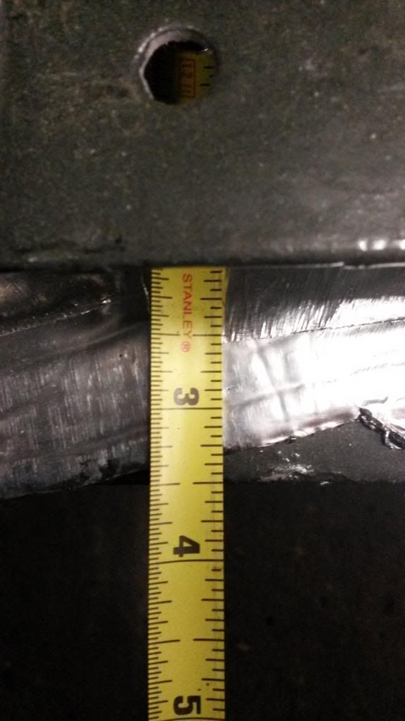

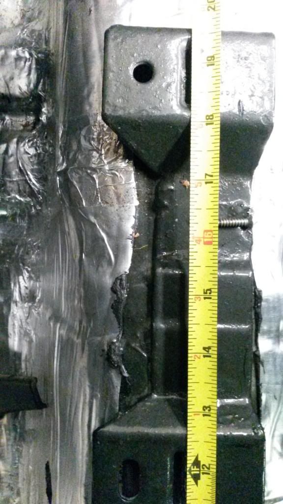

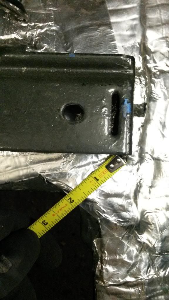

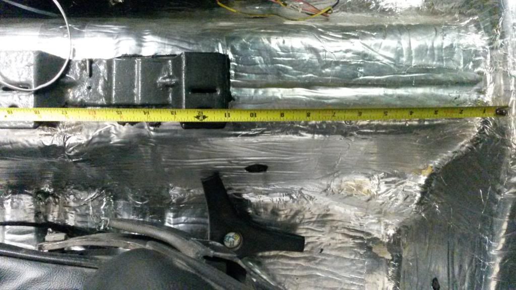

Post by dangina » Thu Mar 27, 2014 10:50 pm
sorry got called back to work - took some pics for ya:
for the rear bracket, from end of tunnel to beginning of bracket - 11"
for the front bracket:
7" to the end
3 1/2" to hole cutout
1 7/8" on a angle to bracket
