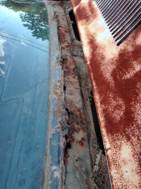

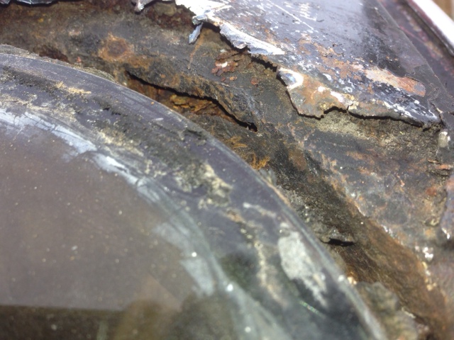

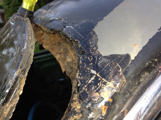

Hey, thanks I'll check that out. Here are a couple of pictures of the problems.

WOW! You have some major rust problems. To my knowledge no one reproduces any sheet metal for around the windshield. You are going to need to find a donor car. How bad is the rest of the car? Did you remove the windshield to see how bad it is? Is the inner cowl rusted also?

Inner cowl, passenger side is bad. Other the. That... The car is fairly sound. Small pieces in the quarters... But the inside is pretty good.

Not too hard to fab small patches around the windshield, inner cowl is tougher.
A lot of these repairs will be covered when the car's finished, a very good thing!
