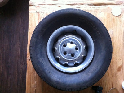

I bet this isn't the first thread about this topic, but anyway.... I need some advise! Wheels and tires make or brake the car, so I want to make a good choice.
I can't decide which wheels and tires to take for my 72 Roadrunner : 15"/16"/17" ??? and what tire size (front and rear) ???
I have the original wheels (14") and I think this too small, but 17"seems too large to me...
What do you guys think about this?

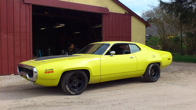

17 x 7" on the front and 17 x 8" on the back... only wish I had found some tires that had more sidewall height. But eventually I WILL.

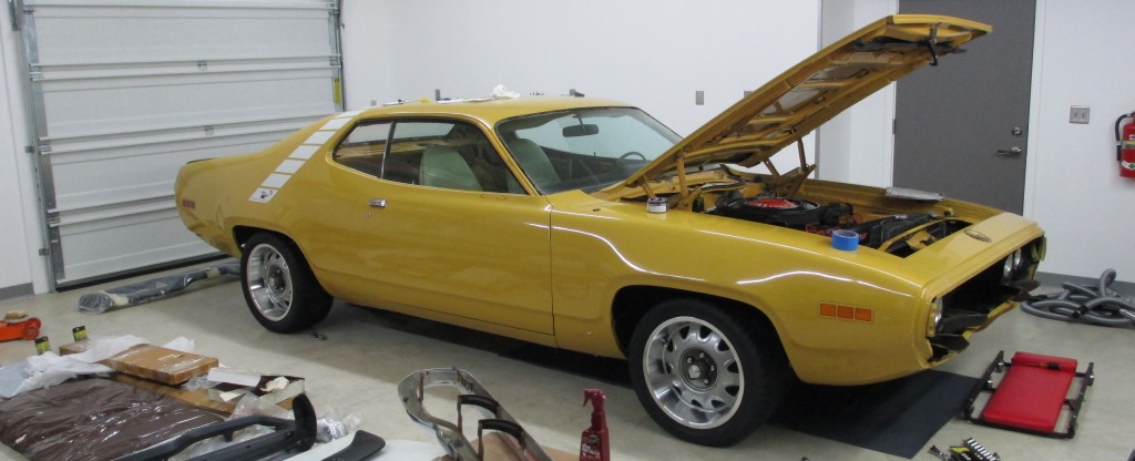

Bruce, what size tires are you running? Do you see any reason why these wouldn't fit on a 1973-74 ?bruce wrote:17 x 7" on the front and 17 x 8" on the back... only wish I had found some tires that had more sidewall height. But eventually I WILL.
Re: 15/16/17" ?
Hugh wrote:Bruce, what size tires are you running? Do you see any reason why these wouldn't fit on a 1973-74 ?bruce wrote:17 x 7" on the front and 17 x 8" on the back... only wish I had found some tires that had more sidewall height. But eventually I WILL.
I'll actually have to check the tire size on the car when I get home this evening... don't let me forget!
As for running them on a '73-'74. Absolutely no reason I'm aware of why you couldn't!

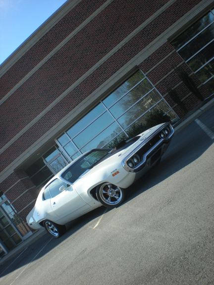

275 45 17s all around

funny you mentioned that Eric, I was going to ask you next! Love your wheels, too BTW! I was looking at those exact wheels. I take it they are the9" versions? How do the fronts clear? I know the 73-74 have iso but I put the firm feel kit on the k frame now it is solid. Front fenders are different, too. Just curious, thanks for your replies. Bruce , I was looking at wheels just like yours, too, and your car, although a different year, is the same color as mine so you photo gives me a really good idea was to the final look. Eric's is the first 71-74 b body Plymouth I have seen a picture of with the new 17" rally's !Eric wrote:275 45 17s all around
Re: 15/16/17" ?
I don't notice any rubbing, but the car isn't back on the road yet either! They are 17x9s
