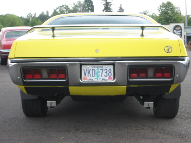

Tail light rear bumper and valance stripe is shown well in this photo:

The hood engine callouts were standard, the A87 package added the indent pinstripes (black vinyl not paint), rear tape blackout (not paint) that Bruce mentioned, an upgraded steering wheel (3 spoke with the horn buttons on each spoke) unless it was optioned up to the rim blow or tuff wheel, wheel opening mouldings and upgraded door panels (two color/insert).
