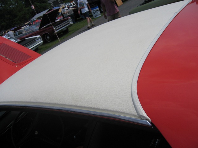

I'm restoring a 71 Road Runner with a V4X Canopy Vinyl Top. Does anyone know the factory stock distance between the two factory seams center to center? Also, is the canopy top molding two piece chrome or two piece black (top color). The car has the A87 Road Runner Decor package.
Re: Canopy Vinyl Roof
Post by Eric » Tue Apr 10, 2012 8:58 pm
there shouldn't be two seams on a V4- car...only the full vinyl top cars had those. the trim should be the same color as the vinyl.
pic of survivor car attached

Thanks Eric. I'll order the seamless deck vinyl top from Legendary. Is the 71 a two piece molding?

the 71 is a 2 piece set. I had mine off a few years ago when I replaced the top. The moldings are not stainless in 71, and they have a textured/grain. Mine is painted black to match my vinyl color.
